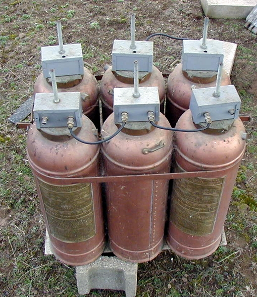

Tidbit: In the early days of 2 meter repeaters, many Hams made 2 meter duplexers out of old copper fire extinguishers. At that time, most of them were either cheap buys or given away. Original copper extinguishers now fetch buku bucks as a high demand item, especially among retired firemen.

i was going to build 1 but seen how much parts cost,can buy a pricy diplexer for less. Actually they are diplexers not duplexers. Suprized nobody got me on that 1 haha

My brain is still wired to old school Duplexers. Ha! For reference, this is a photo of a 2 meter 6 cavity Duplexer made from fire extinguishers. For those that don’t understand the difference between Du and Di, this Ham provides a good explanation.
http://ae6pm.com/SCCARA-GRAM_Articles/Duplexers_Diplexers_Circulators.pdf

thats what i read long ago diplexer is for a uhf port and vhf port on dual band radios in 2 meters and 70 cm with 1 port for dual band antenna.
Duplexers are for a radio broadcasting on oh say 146.600 and recieve on 147.200 with a transmit port and recice port plus a port for single band antenna
