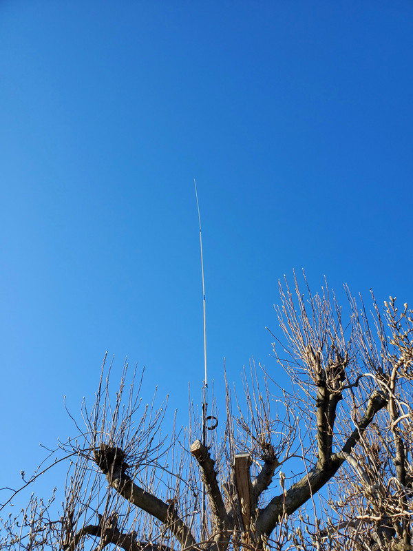

5/8 on 11 near 5/8 on 10 close enough to get out and have a decent SWR.
on 12 bit too long for 5/8 close enough to have good SWR and get out, on 10/11/12 no tuner needed here with my 20 year old Imax 2 K.
on 15 it is a 1/2 wave SWR 1.8 there, good enough for internal tuner of the radio's here to work good enough.
The Imax 2 K is at 11 meters above ground with the base fed with 15 meter coax comparible with LMR 400.
Almost every day i work here withh FT-8 from New Zealand, aussie, china, Japan EU south africa, south america and USA /Canada.
Good enough for me, the Fritzel OCF FD-4 also works on 10/11/12 but mostly vertical is working just a tad better.
In the end i don't mind SWR to be under 1:2 just 10% loss nobody notices.
I look at the results i get with it, working all continents regularly now with the Imax 2 K says enough for me.
Compared to other 3 band ham verticals with traps i now have 4 bands to work with good results, no traps that go bad and also have losses.
And enough spare parts of old Imax 2 K antenna's for the rest of my life, having been given/ bought for scrap prices when lots of Cb stations here gave up.
On Digital modes i run anything from 20 to 100 watts there, i can make 1000 watts here withh the rebuild Heathkit SB-1000 the imax can handle that whistling from fun.
Hardly use the amplifier, most of the time 100 watts does the job.
From 160 to 6 meter were the FD-4 also works fine ;)
Is it perfect? no, do i need a separate peaked antenna for each frequency? nope, the Imax doees it and the results are there.
Get off the high horse beng purist use what you have or can use.
