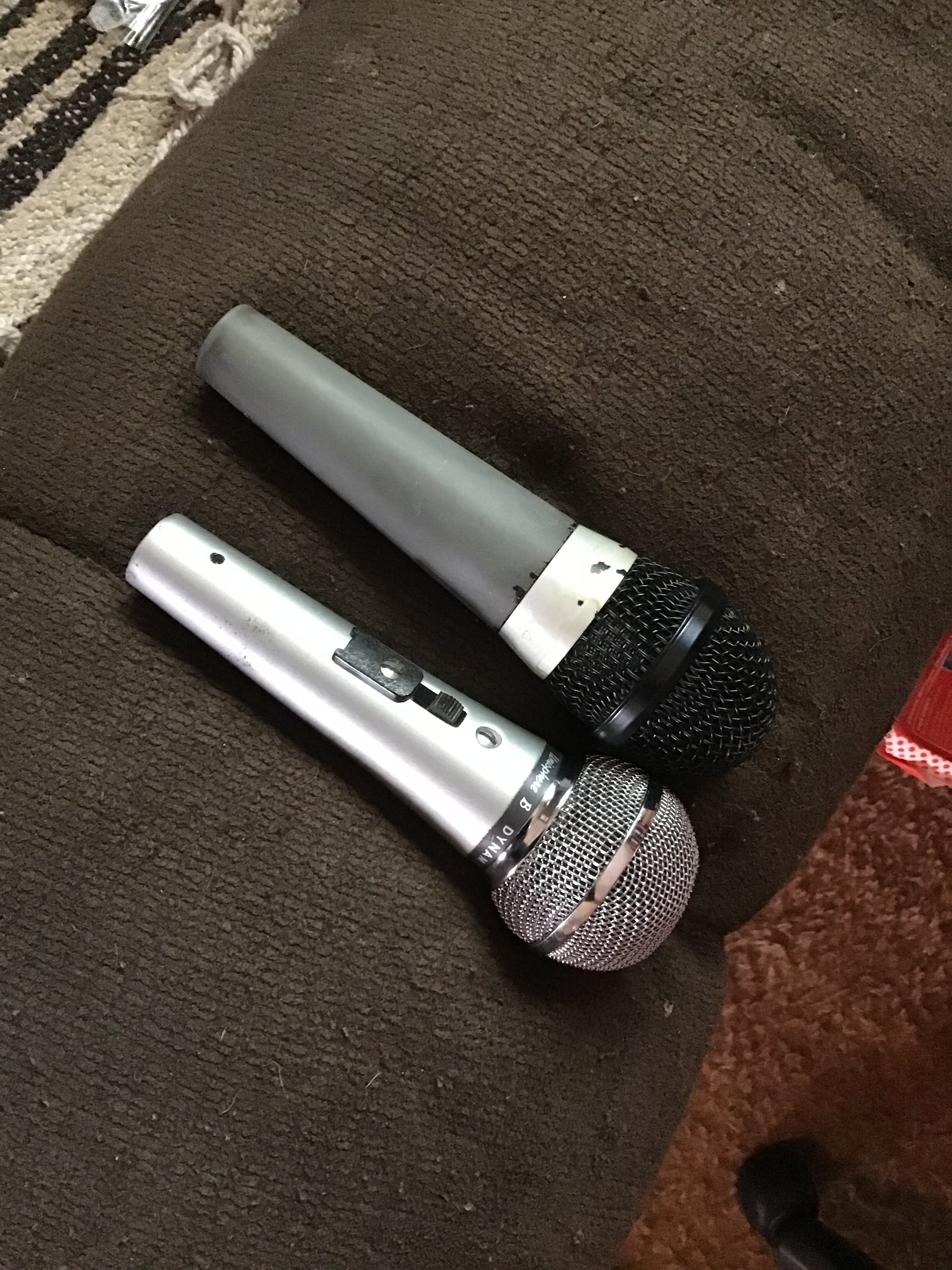

A couple of weeks ago, I was just browsing around the somewhat expensive DX engineering site, (did I say that), and I stumbled across this INRAD microphone and base combination. I was immediately intrigued. Because what separates this from all of the other desk microphones that I’ve ever had, this is the first product I’ve ever run across, brand new that is, that permitted me to hook up any XLR microphone to it, and just talk. I just so happens that I have several of these old microphones laying around. some I got from our Church basement that has long been retired, some I got through horse trading, and honestly, some that I don’t even really know how I got them. But lo and behold there they are in my box of junk, like the one sock missing it’s mate. I thought to myself, how cool that would be, to have that base stand and I can just put my own microphone in it. Product link https://www.dxengineering.com/parts/inr-dms-1

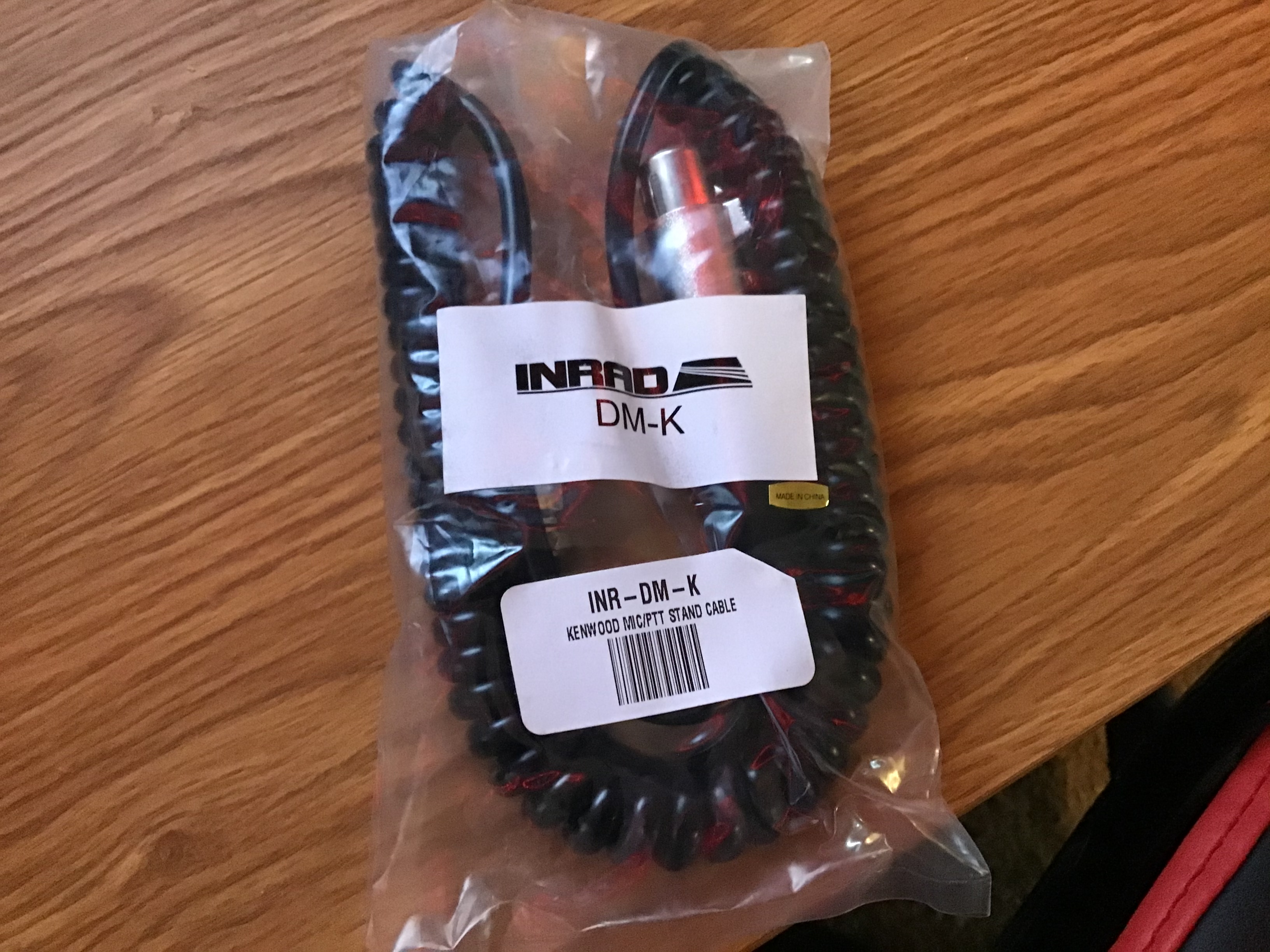

Apparently this base is made to hook up the inrad microphone to, which is a separate purchase. But as I previously mentioned, I did not need a microphone because I have plenty. I wanted to try out my own first. You will also need to purchase a cable for your particular radio. there was Icom, Yaesu and Kenwood. I went ahead and purchased all of them, because of all the radios I have and all of the buying and selling and trading I do here, I figured that eventually I would need to attach it to just about everything that passed through, besides the cables was only an extra $12.95.. That is certainly much less than the special Heil boom cable that I paid over $35 for. So just to be clear, your initial purchase will consist of the base stand, which comes with the 3 pin XLR cable to hook YOUR XLR microphone to the base. You will then need to buy one more cable to connect this whole base to your radio, specifically whichever radio you have. There were 3 cables to choose from, all for the 3 big radio companies.

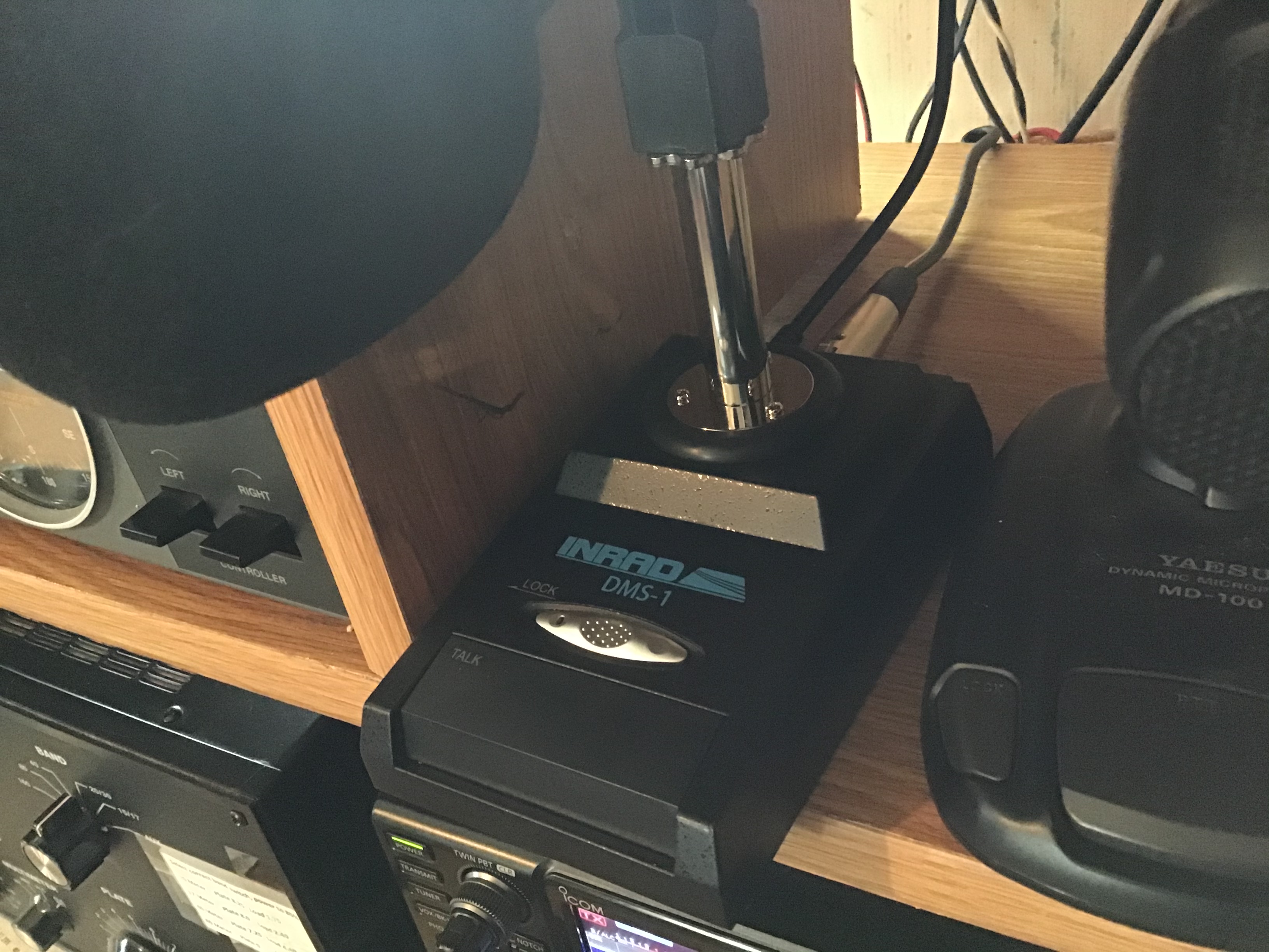

Well, this setup arrived today. I greeted UPS on the street, and happily took off running with my box like a dog with a treat, hiding under the sofa so the other dogs didn’t steal it from me. As I unboxed it, it was just like in the pictures. I knew that the base was going to be heavy because I had already read about it, but boy they was not kidding. I’m not sure what kind of metal it’s made out of but it feels like cast-iron, and if I had to guess I would say it’s at least a good 3 pounds. Very very sturdy to say the least. No microphone sliding around here, Felicia. The only thing I had to do after unwrapping it out of the plastic, is to screw in the neck to the base, then screw on the mic clip to the neck. There is a screw to butt up to the holder when you get the right angle, so the holder don’t keep spinning. I already knew which way it went in by looking at the pictures when I ordered it. then I attached the included cables, inserted my microphone, and hooked it up to my radio.
First of all before I go on to how it sounds, I just want to tell everybody about the fine quality that this thing feels like. And I’m not kidding you, when I press down on the microphone button it is very sturdy and precision feeling. Not creaky and plasticky, not shaky or anything else, but just a good solid professional feel to it. I was already very impressed with the build quality of this item. But, the big question,,,,,, does it work :;

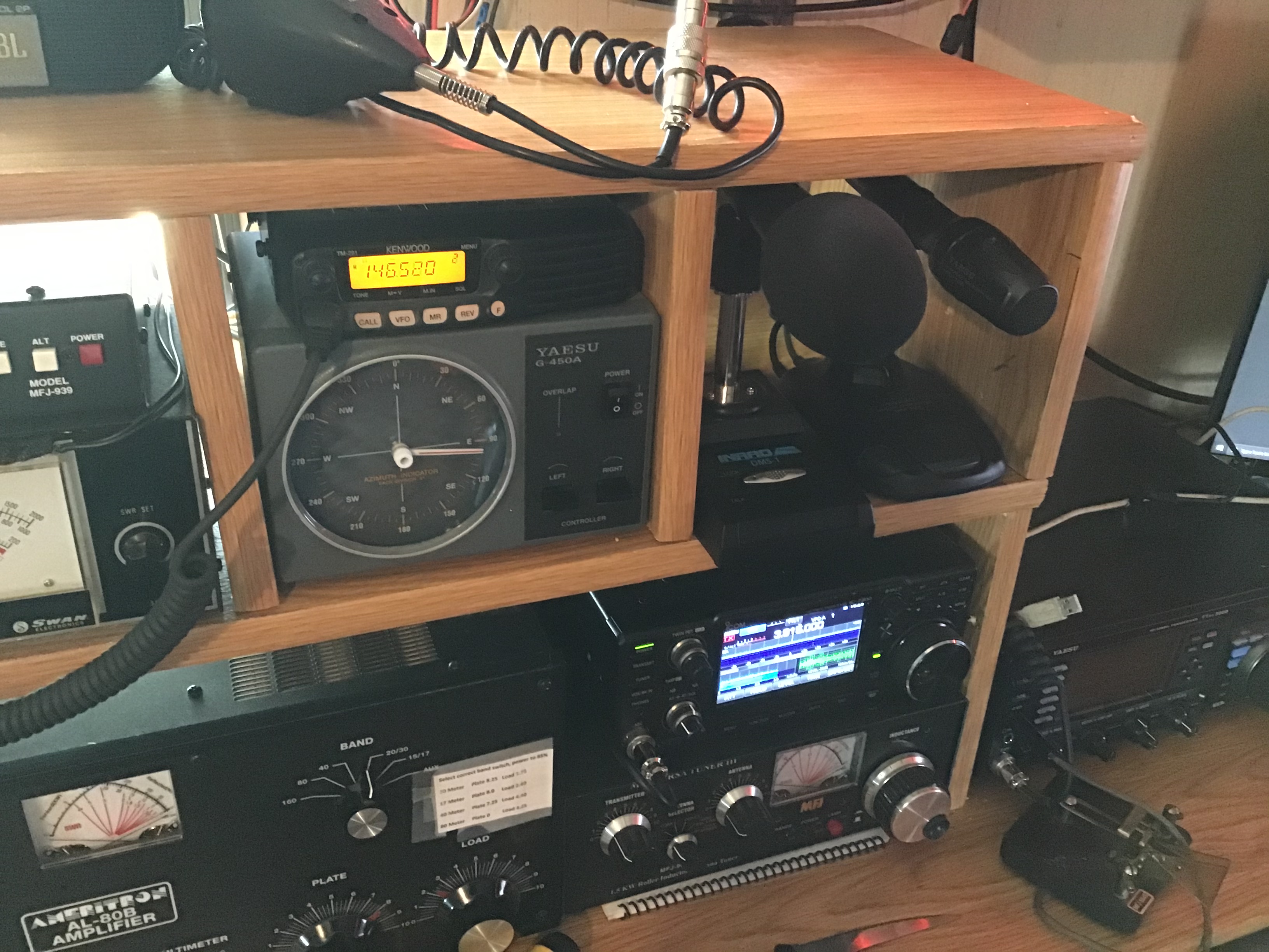

My chosen weapon was my Icom 7300. I have plenty of radios to try it on, but this happens to be the closest and easiest to get to. I went into my settings and adjusted a few different things just to hopefully get it into the ballpark of what I think that it needed to be set at. I was quickly disappointed when I spoke into the microphone, that my ALC meter did not move at all. I double checked the microphone, and there was a little slider switch on the top that was turned off. DOH. So I slid a little switch forward, and then tried it again. Still, the ALC meter did not move. I turned up my microphone gain all the way up to 100%, and turned the monitor up, then I turned compression on. lo and behold, there was life. A squeally life, but it was there. But I did notice that I had to get pretty close to the microphone to get the ALC meter to move up to 50%, which is recommended by ICOM. I was hoping to be able to sit a little bit away from the microphone so I wouldn’t have to bend forward. but I tweaked a few more settings here in there, and I finally got the ALC meter to move up to about half The recommended scale with me sitting comfortably about 2 feet away from the microphone. A nice enough compromise.
I had no choice but to get on 80 meter, it’s a long story that’s neither here nor there. It’s the only antenna that I can use for now until I can get outside and fix my other one from a recent arm wrestling match with a windstorm that ultimately reigned supreme. Not my ideal choice, simply for the fact that it’s in the middle of the daytime, and I knew that the band conditions were probably going to be less than ideal, if not flat dead all together.
I did find a few people talking here in there as I scrolled the frequencies. But every time that I tried to communicate with somebody I did not get an answer. I was starting to worry that my microphone was not even working at all, despite what the meter said. So I started swapping them around, reaching into my junk box and trying this one and that one but everything remained the same. I finally just put my old trusty Shure in that I started with, and left it alone. After a series of trying, somebody from Tennessee, which is only two states south of me, came back and said that I sounded really good. He did say that everybody had left because of the band conditions, where nobody could hear each other, so that explains that. Which I pretty much knew already. I was concerned that my set up is just not working as well as it should. So that was actually kind of a relief to make the QSO.
After the conditions finally dropped and I could no longer make QSO with him, I decided to jump down to 20 and I just use my automatic tuner and tuned the 80 m dipole up and see what would happen. Fortunately for me I did make a contact up in Michigan. And the guy helped me dial things in just a little bit better. after turning my compression setting up just a little bit he said it came in really really nice. so this was fantastic! I have this desk microphone now that’s not restricted to any specific radio, I can just swap around the cables it will and use them on my Kenwood or my other radios that I have around here. Plus it just looks soooooo sexy on my desk .
