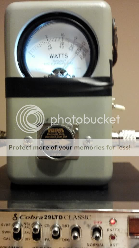

On what meter? Just not seeing that, sorry.
Since you're not seeing it, I'll show you then.
This is a Cobra 29 Night Hawk I worked on.
Test parameters: 13.8v power supply. Bird 43 w/ Bird PEP kit & Bird 50A slug. 500w dry dummy load.
Here's another 29, just a normal LTD Classic. Also getting +/- 40 with the same BIRD meter and test parameters identical.
