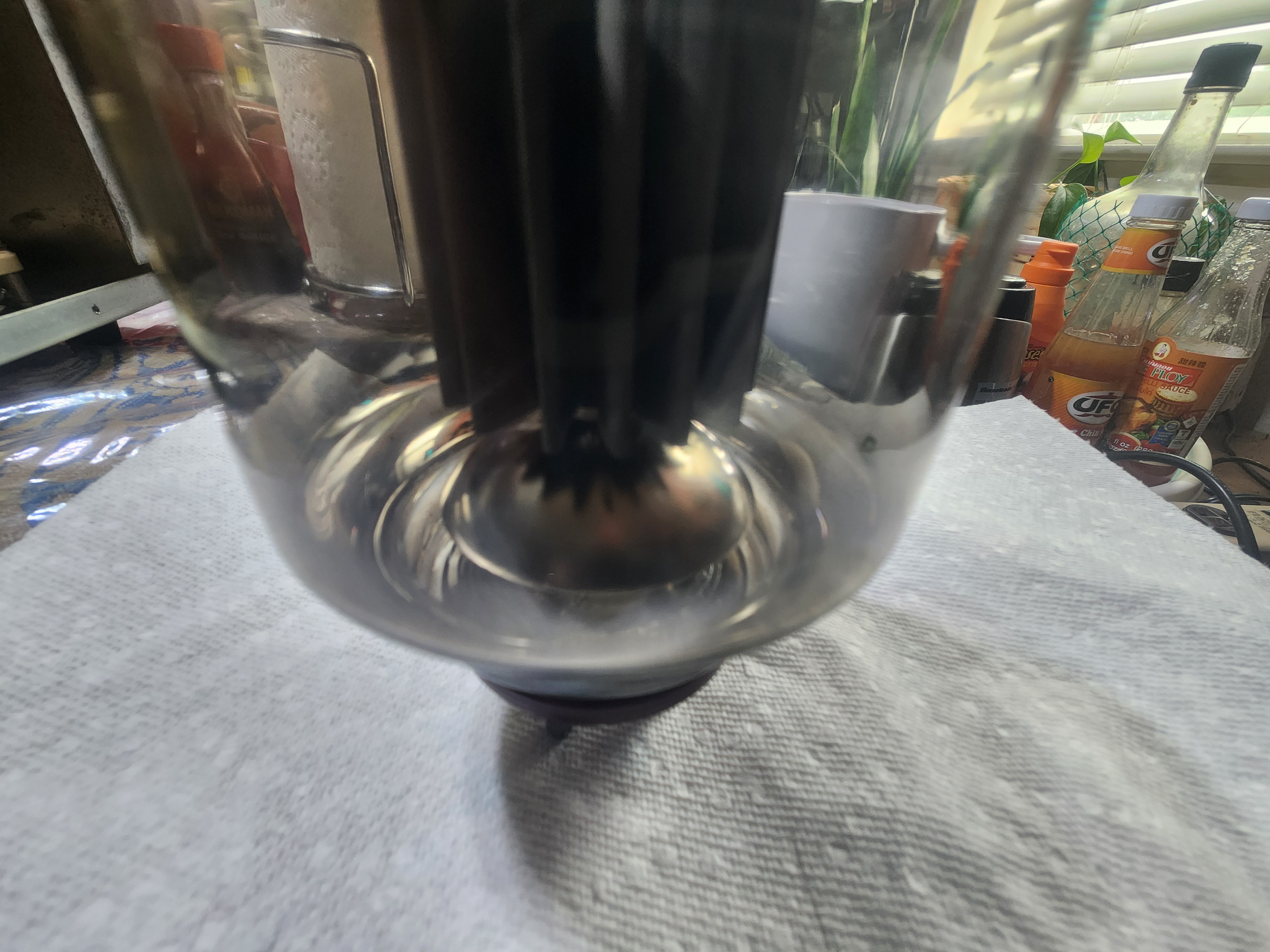

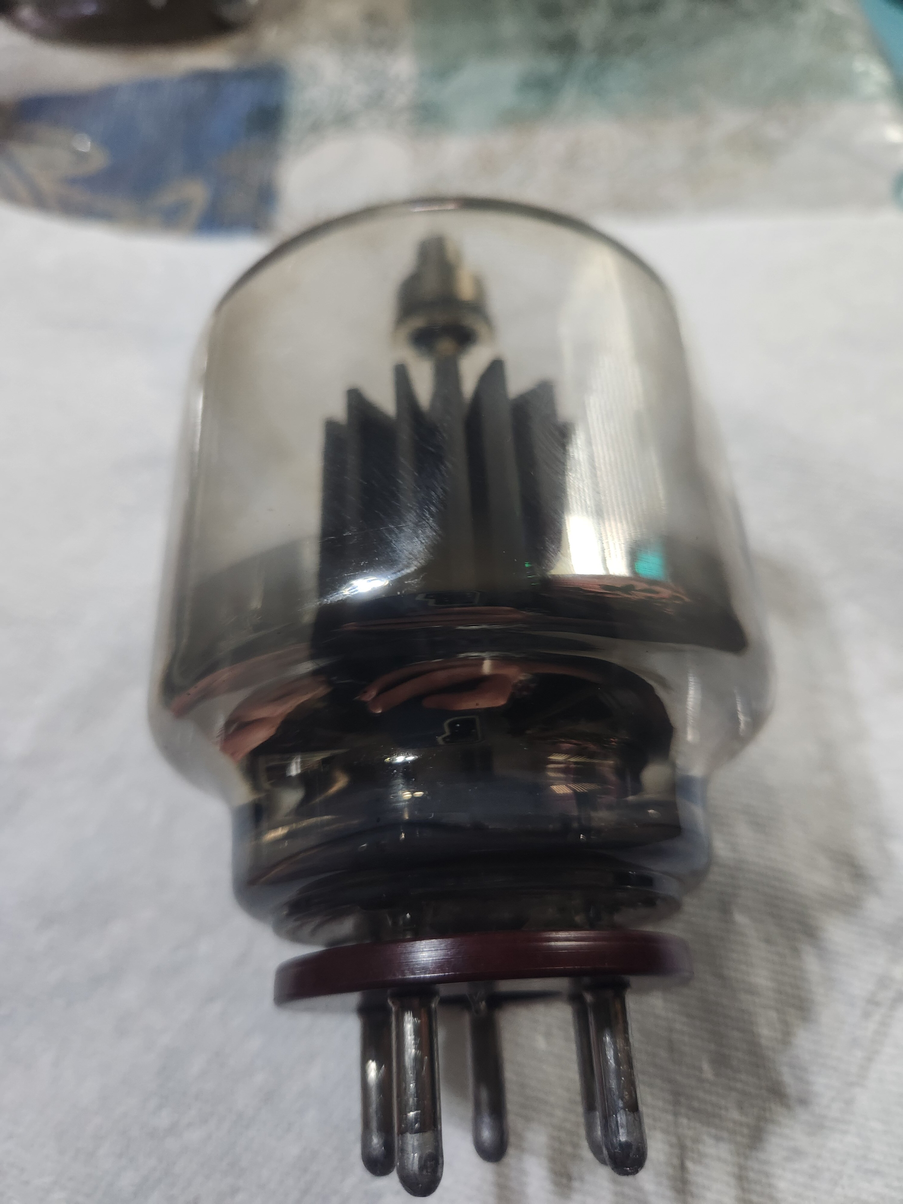

Is my tube soft..... very funny .... the AMP tube....

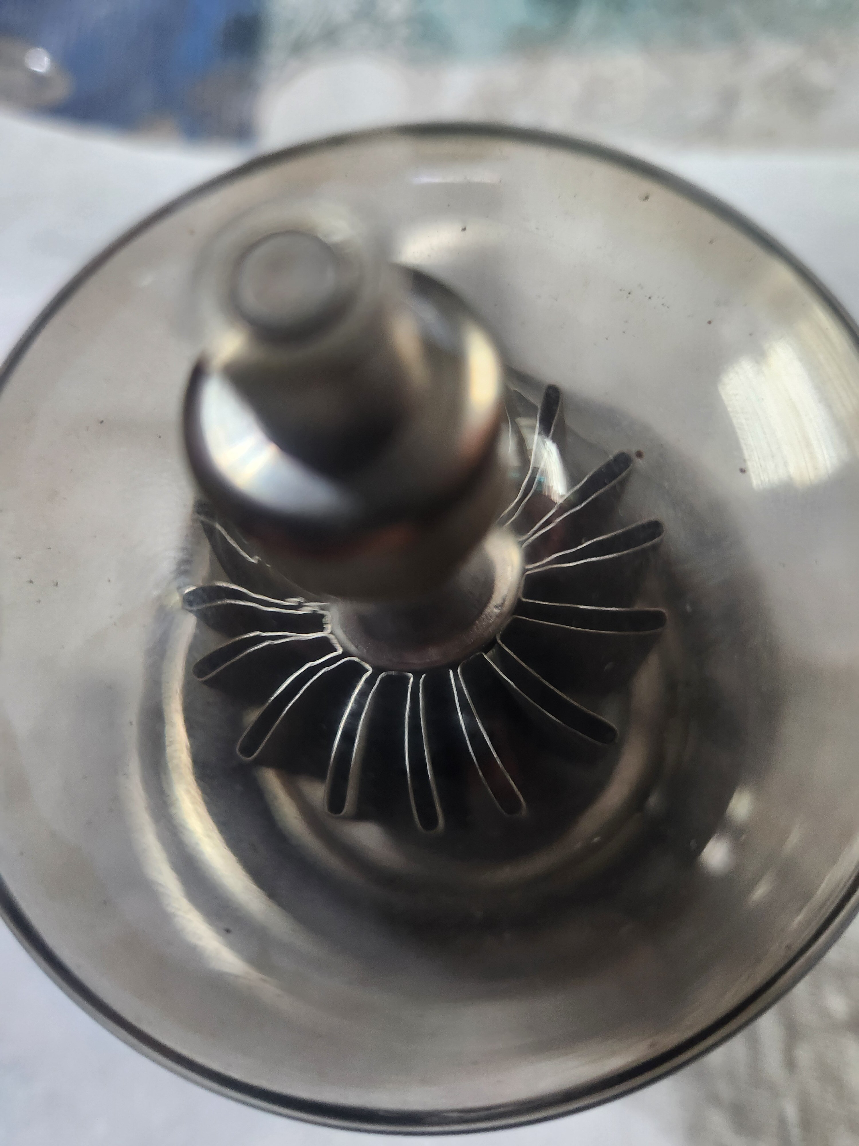

Oh I wouldn't think cleaning out the inside of the amp a bit and swapping a tube would qualify me as any kind of repair person whatsoever lol. Old tube had a chrome effect on the lower 1/4 of glass like the old 6LQ6s etc used to do.
No markings left on the tube. Looks like Eimac style but no silk screen anywhere left on it. It still works but probably is at about 70%. I'll keep it as an emergency spare.

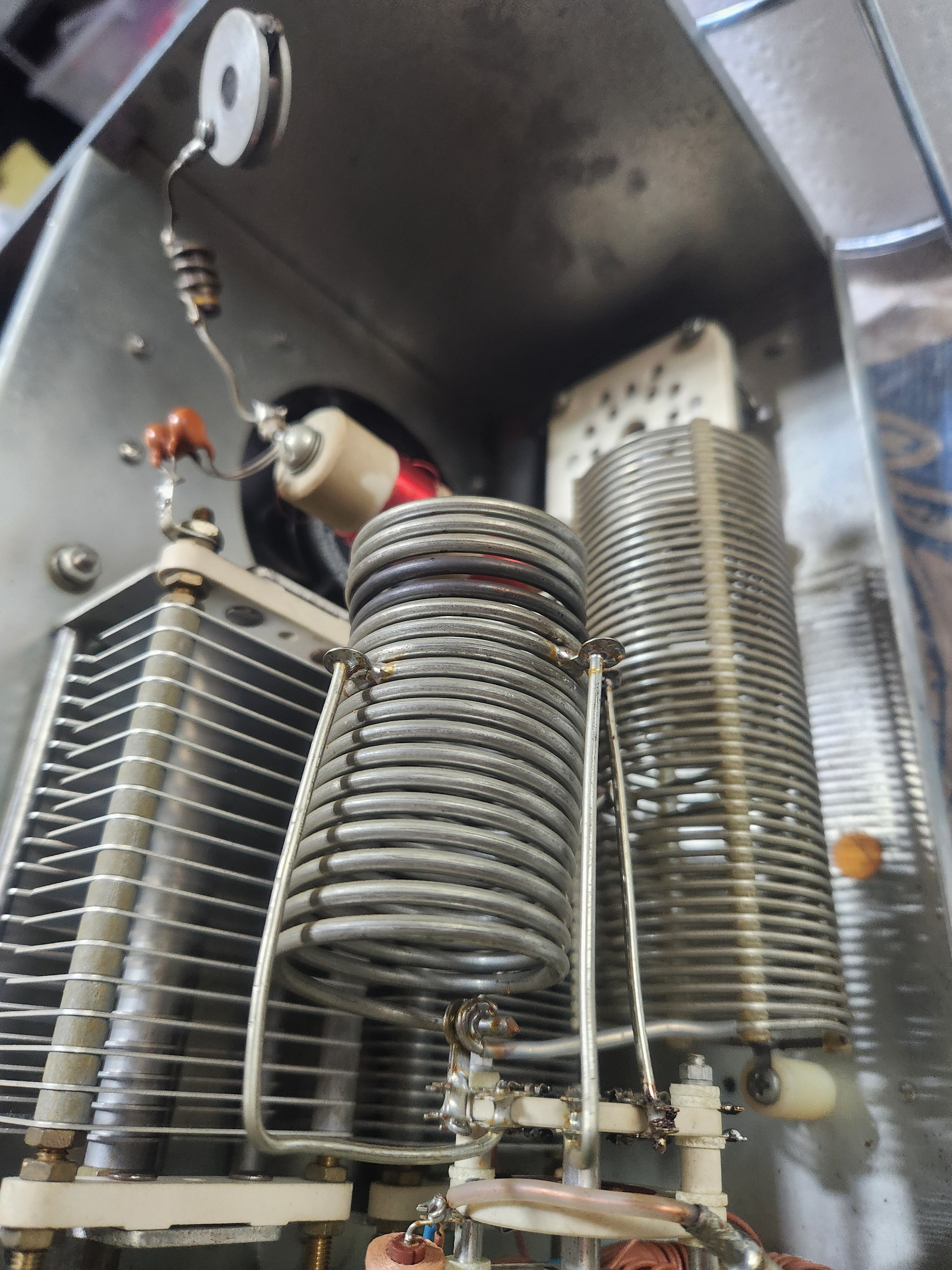

I did notice one thing, other than extremely dirty inside of this amp which I did clean up some.... I do not think my tank coil, that is my tank coil right, is supposed to look like this? And is there any way to clean it without harming it to remove whatever that is ...oxidation, scorching, whatever it is? Figured you experts will know vs me mangling a presently working great amp!
The coil was red hot at some point. The silver plating is oxidized, I would leave it alone.

Ah. I purchased it used dont know much about its history. Thanks for the direction Lid. I will leave well enough alone.

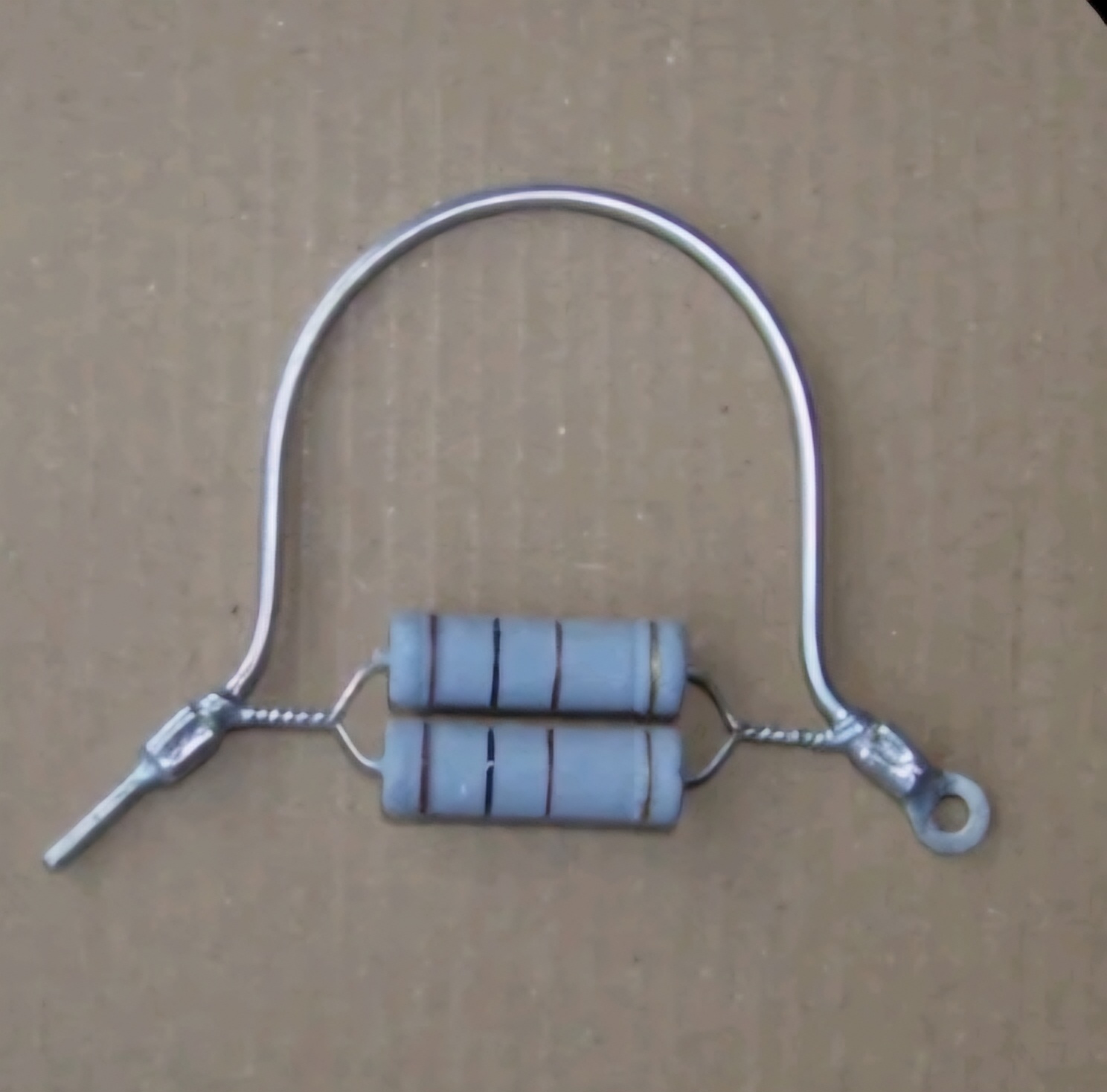

Oh on the anode? No its one of those old dark brown bakealite things...
LOL That IS the parasitic suppressor. It consists of a carbon resistor somewhere around 40-60 ohms and the coil shunting it. Easy to check. Lift the anode cap and remove one end of the coil from the resistor to measure the resistor.
I know I was answering Lids comment about it looking cooked its just very dark brown lol.
