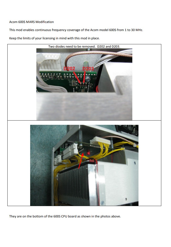

Hello , can you tell me where I can find diodes d202 and d203 in acom 1200s , I can't find it. Please , and thank you
In the above PDF file is this image.
User Udo has never reported back about the issue of not working after the modification, as always proceed at your own risk.
