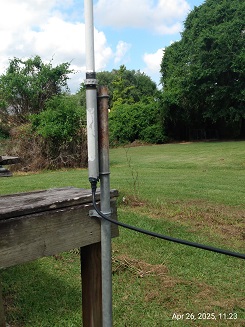

I have my old A-99 mounted to a five-foot mast with the
coax going at a right angle to my house and radio room.
I will put it back on a taller mast again.
Works great on "27 MHz CB" 29.000 MHz AM and 29.600 MHz FM.
the mast / radials / CP are the other half of the antenna.

Thanks for those Henry. It seems I will just ensure this metal mast is not grounded as I do not have a non conducting mast. I can isolate the silver rod from the mast (removing a DC short to its bracket - A basic Sirio GPS 1/2 ) but the mast is still conducting, being aluminium.
It seems to be working ok as it is which is basically non grounded. I just up and down the mast as needed it is not up permanently.
I wired brushed the SO-239 outside and in a little as it is looked lacking in shine, looked very cloudy, that will ensure a better coaxial contact.
