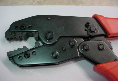

This is the crimp tool I use with a second set of dies for the 8x. Bought it a few years back and from this same source. I've bought all the crimp connectors from him too and they've yet to let me down. Silver/Teflon crimp and solder.
I have essentially the same tool with the Anderson Pole jaws, and solder-less connector jaws. Very versatile tool and built well.
That's a good price for that crimping tool. Mine cost me that about 15 years ago and I see many of them now for double that price and even more.
Reactions: Eldorado828
It's a nice tool, I didn't get the Anderson die though. I know crimped Andersons are fine but the odc still has me soldering them.
Got it from that seller above 3 or 4 years ago and has made life much easier. I do use it on 8x with marine grade heat shrink that has the adhesive inside, they've held well on mobile installs.
For any of my installs I don't think solder/solder amphenols will ever be needed again, but do have them just in case. Crimp solder is the way to go.
