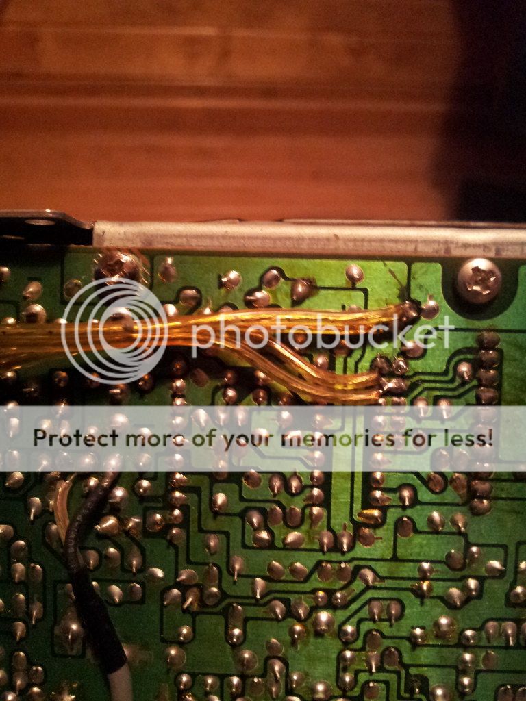

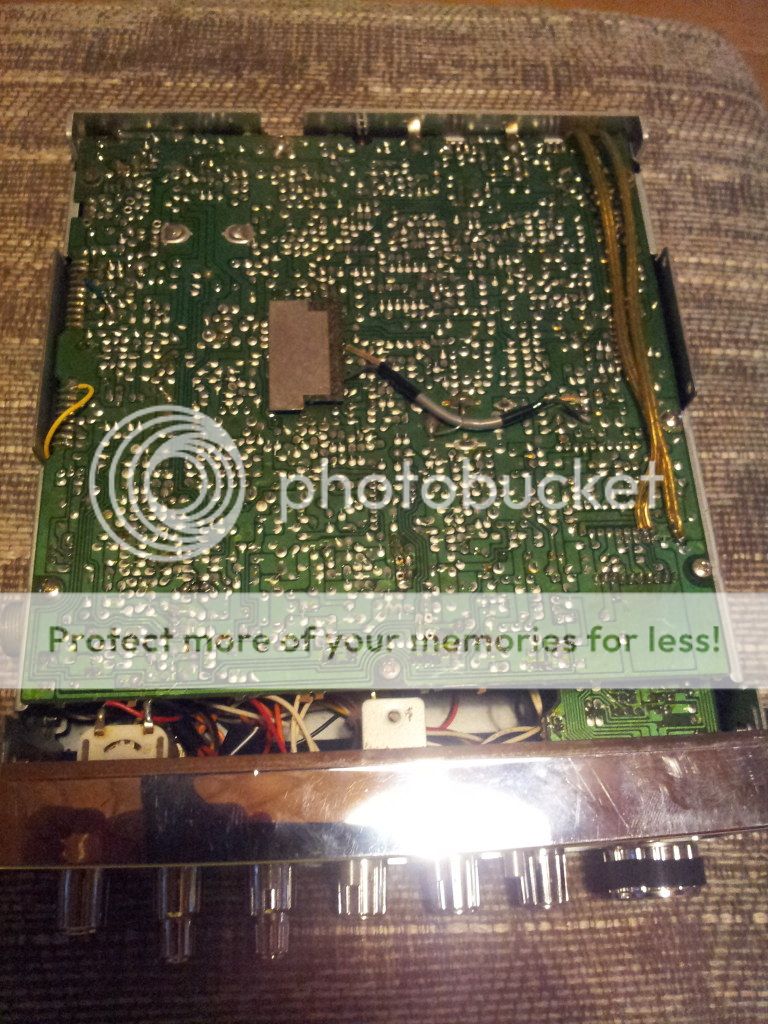

tell me what i have here, know its extra channels, theres two switches on the back. what to i have to do to use them. what position do they have to be in. what frequency/channel are they. remember i'm new to all this
