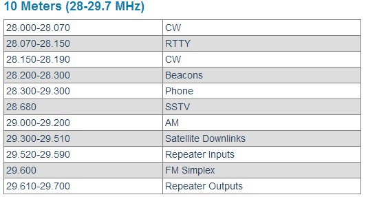

Does this look accurate?
Where do most new hams start on Radio Not fone?

28.300-28.500 USB. The band is pretty spotty lately, but I had Venezuela/Brazil and a pre-contest dude down near Haiti. Also have Oregon in very strong today. 10 meters is pretty fickle, but sometimes I think it's because Hams don't talk on it if it's quiet. You can go to 11 meters and there are tons of people coming in, but 10 will be quiet. I actually heard a bunch of guys discussing this very subject this morning on 10 meters.
