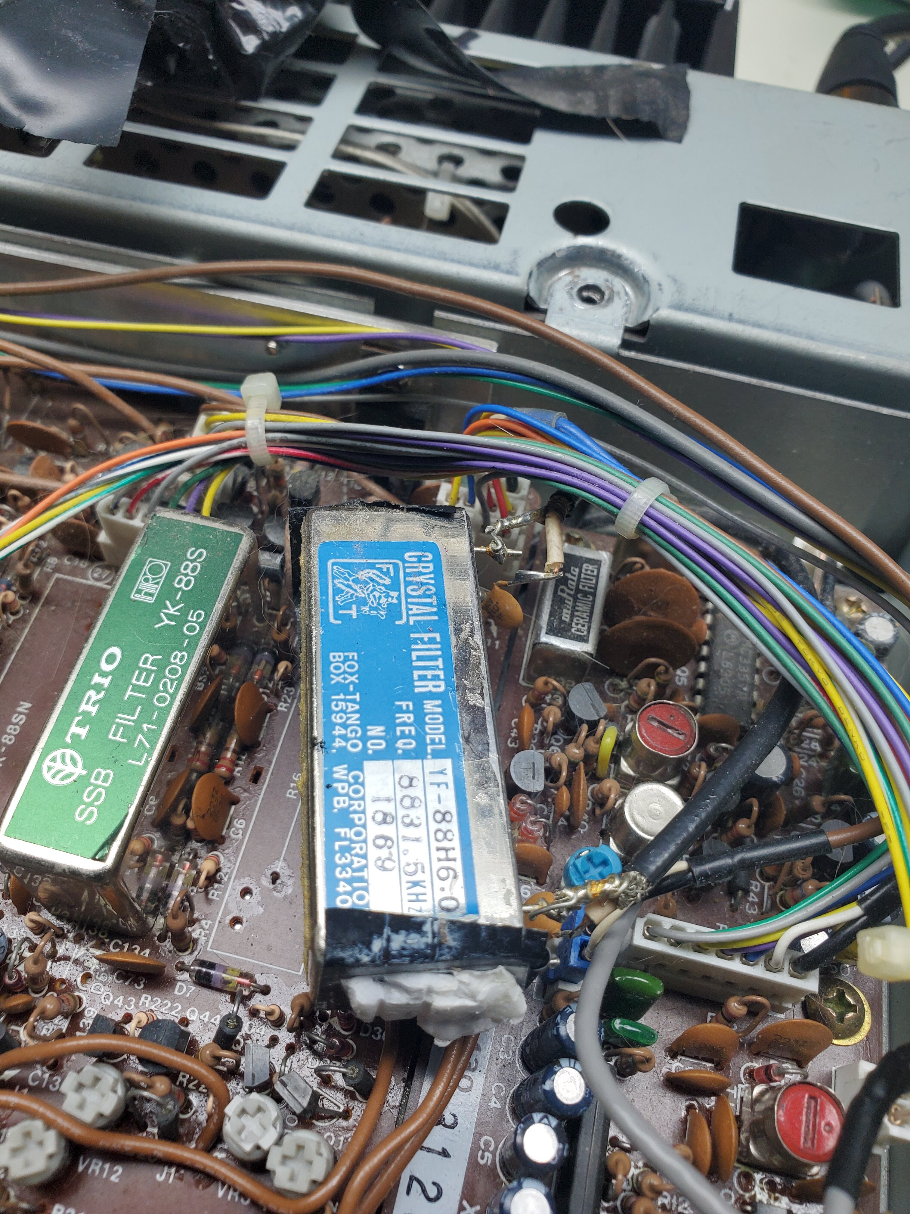

I have a 430 that am mode seems to be pooched. Upon top cover removal i find a taped up mess and what appears to be an incorrect am filter sitting in the spot where the am filter would be soldered in. Looks like this thing was spliced in to a small coax type wire. Thinking of trying to remove it and re-attach / splice the wires back together. Just maybe am mode will work again.
Your AM filter, is a Fox-Tango, which then became International Radio (INRAD). It is an 8 pole discrete crystal lattice filter, which is physically larger, than the Kenwood filter, so it needs to be wired in. It is a much better filter than the stock Kenwood filter, so consider yourself lucky. Hopefully a cleanup on the install will resolve your issue.
good times. :).otherwise she works well on ssb which is key for me. Having the am right would be nice. Pretty sure i need to lift the board(s) out to see what they comandeered under with the wiring to the filter. A botched job regardless. Will do my best :)
