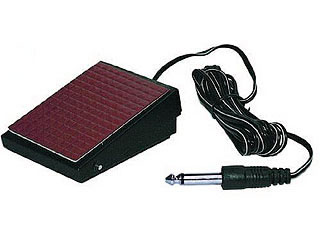

Heil makes a footswitch also. What I like about the Heil FS-2 is that it has two separate microswitches, set so that one actuates just a few milliseconds before the other. That way, you key the amplifier first, and then the transmitter. Much easier on amplifiers that way.
