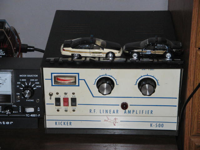

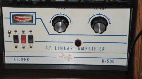

I got this about a year or so. Took a chance on it as i could not test it at the time i got it. It looks just like you have just taken it out of the box brand new. The person i got it from was asking 100.00 for it and he said it worked. I offered him 80.00 for it and he took it. Like i said i took a big chance on it. Got it home and did the test on it. It worked as good as it looks. Everything works on it, all the lights and the Hi-Low switch. Just wondering if anyone else has ever had one. I ordered me two extra tubes for it in case one gets week or goes out. Now i do not know how true this is, but i live about 12 miles from a little town from me. The person i was talking to said my radio sounded real good, and i was hitting him with about 8 pounds. I kicked the K 500 on and he said i was hitting him with 20 DB. So i guess i did get a good deal. I hardly ever use it and i do not know if it is bad to let one set. If i do turn it on, i will keep it on stand by all the time unless i am using it. I was told it is hard on the tubes to turn it on and off. That i should just leave it on 24-7. Anyone got any info. on this? Thanks

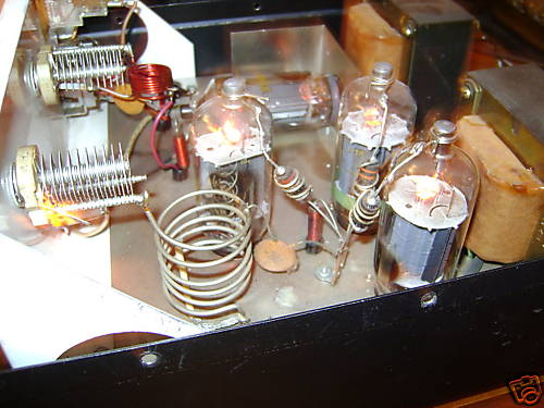

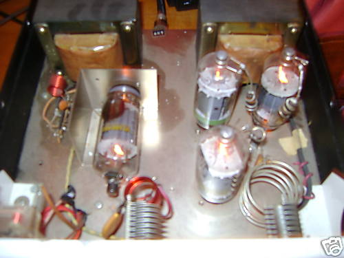

Here is pictures of the inside of my K 500. Also i have the schematic for it, that i would be glad to share it with you. Please email me at bigal46563@yahoo.com and i will send you a copy of it. Thanks

I had two of those.
Same as a Firebird 500.
Sweep tube amp, good for 300W or better. One driving three.
Yes, you got a good deal.
The last one I had, I paid 125$ for it and sold it for 250$.
The switch on the far left was added. What does it do?
The down side of that amp is the fact that TV sweep tubes are hard to find and expensive.
When it was built (probably the 70"s), that were plentiful and cheap.
