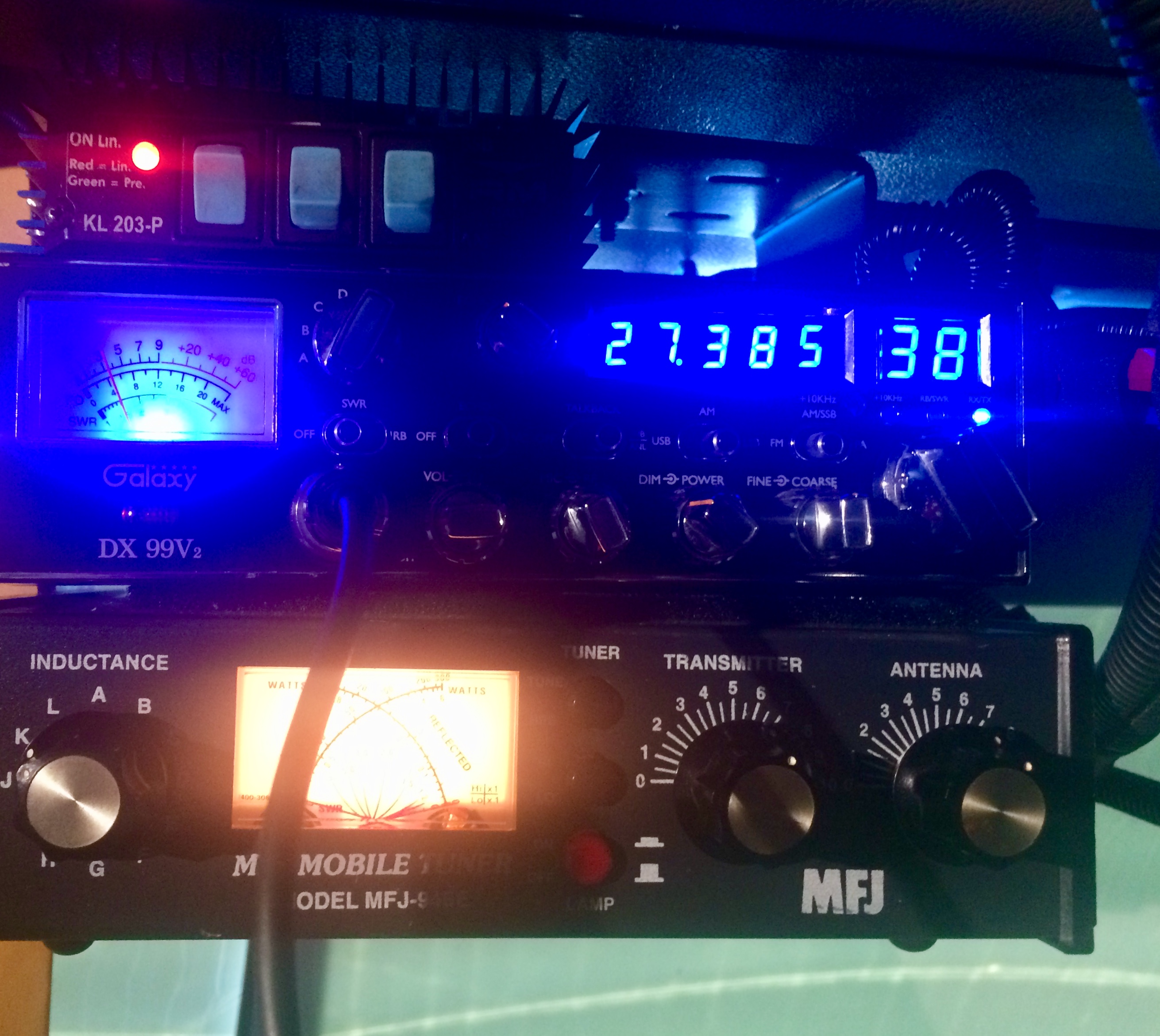

I leave the KL203-P drinking thru an 8W fire-hose (ha!) from the Galaxy 86V . Tuner shows 90W + (1.5W Reflect) after the bandpass filter. That little amp has worked pretty much every day of the past 2.5-years. Call it 550-600 days.

Older pic with the 99v2 onboard. Tuner Inductance changed to letter “H” (“L” is least amount), and Capacitance stays at 6.5 (5 is one half) after changes from pic
I’ve had no complaints, per se, about audio or other (turn Mic Gain to full), so things are okay for now. .

Guess my -P model is double super-secret badazz, huh?
I’ve asked for on-air comparisons on AM-19 and the only reply has been its “less loud” when I reduce power at the radio.
Audio quality said to be about the same.
I’ll try again. (And, no, not for sale).
