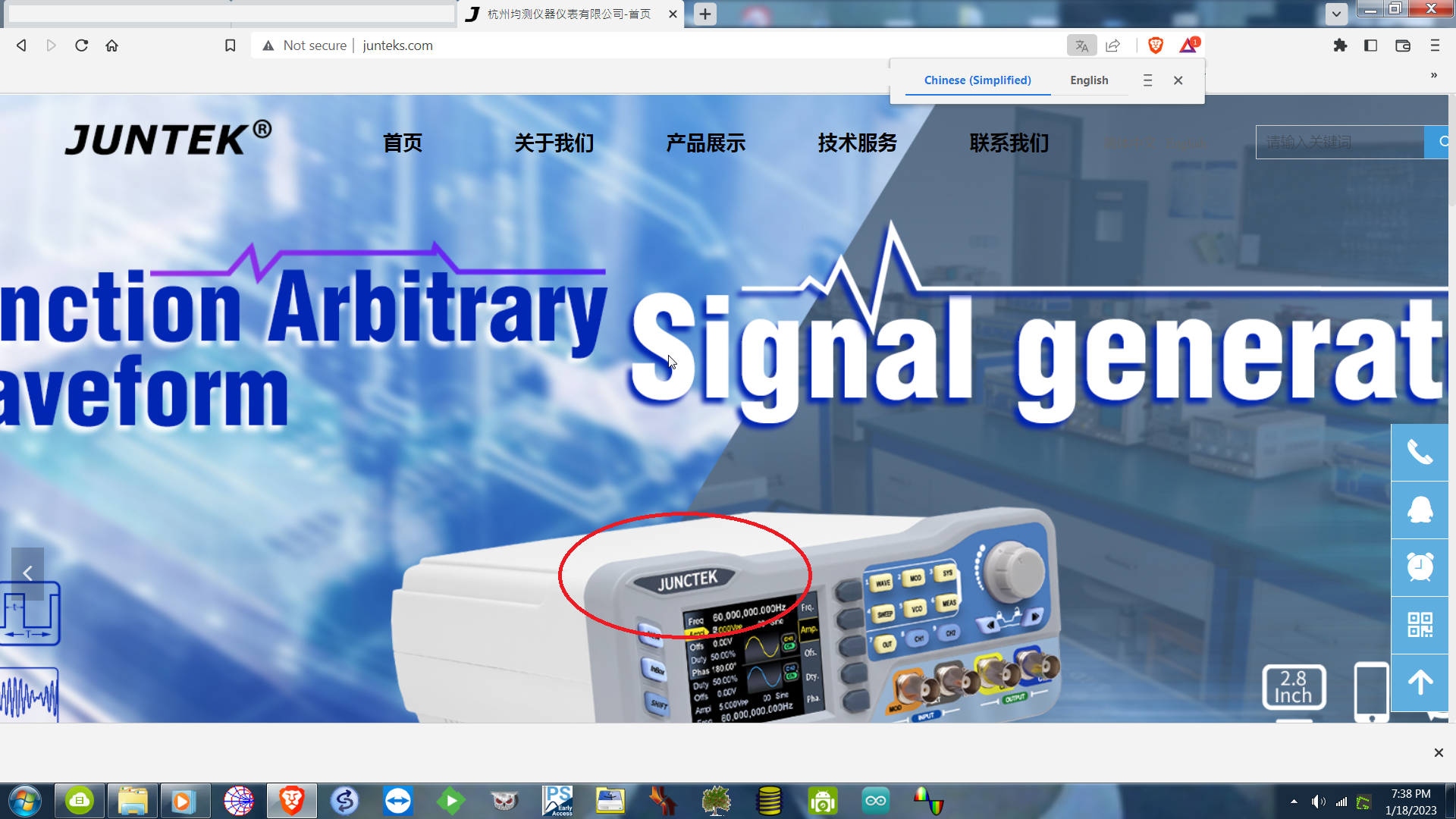

I gave the new "budget" signal generator from amazon a shot because it said it did modulation (both internally and from an external source) and I have a few thoughts just minutes out of the box. First one from the originating company's website (which I didn't notice until now). It turns out they actually got the branding right on one of their products! Don't believe me, check out their China website and watch the scrolling pics! I didn't photoshop that, they actually misbranded one of their products with the name "Junk"! Either they cannot spell their own company name, or one of their workers decided to leak the truth on their products and nobody noticed!

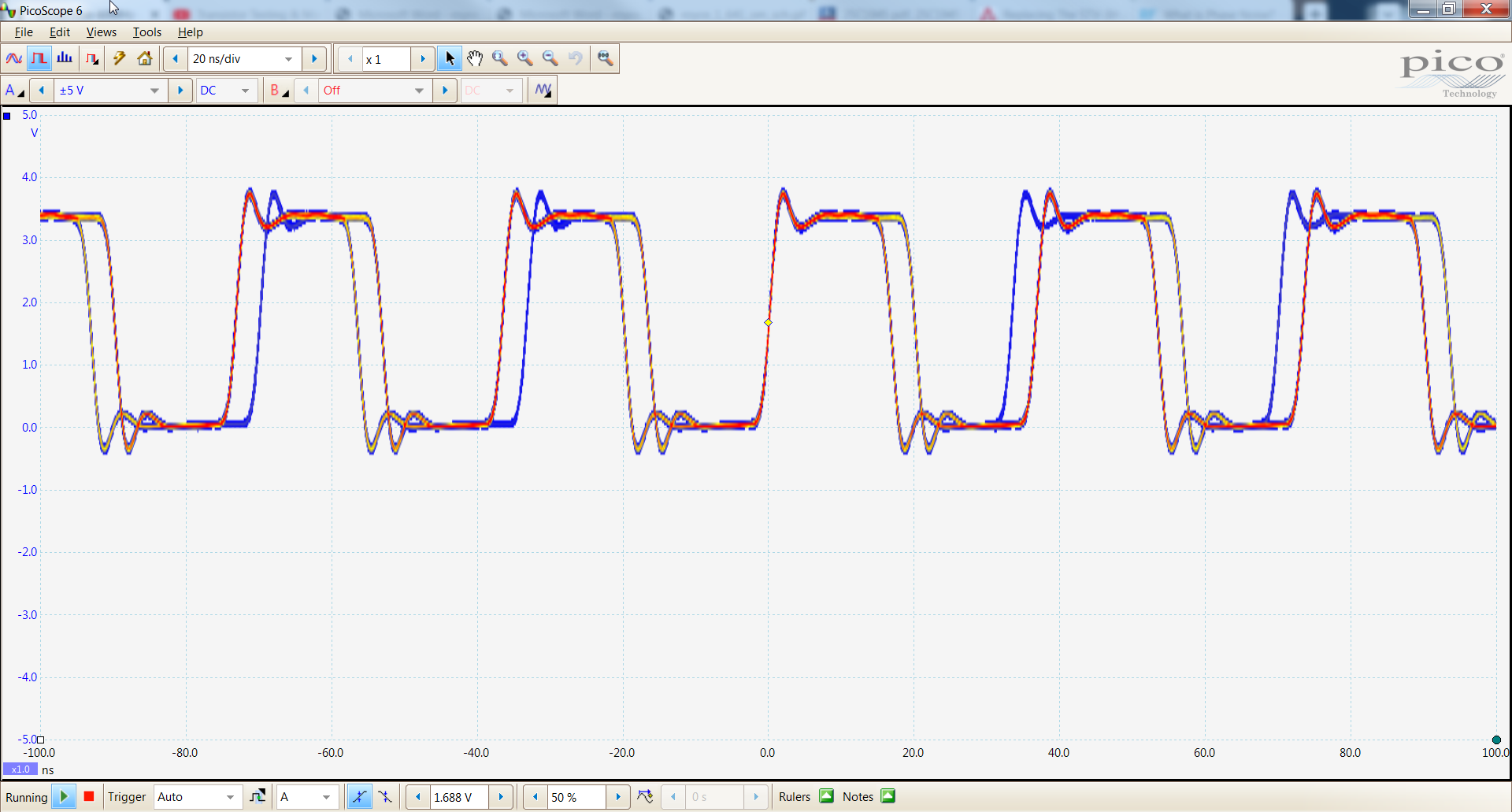

The source of the noise is the Sync in and out ports. The sync out is outputting a square wave at the set frequency (currently 27.385MHz with the front outputs off) and it looks like it is also trying to oscillate on roughly 30MHz too.

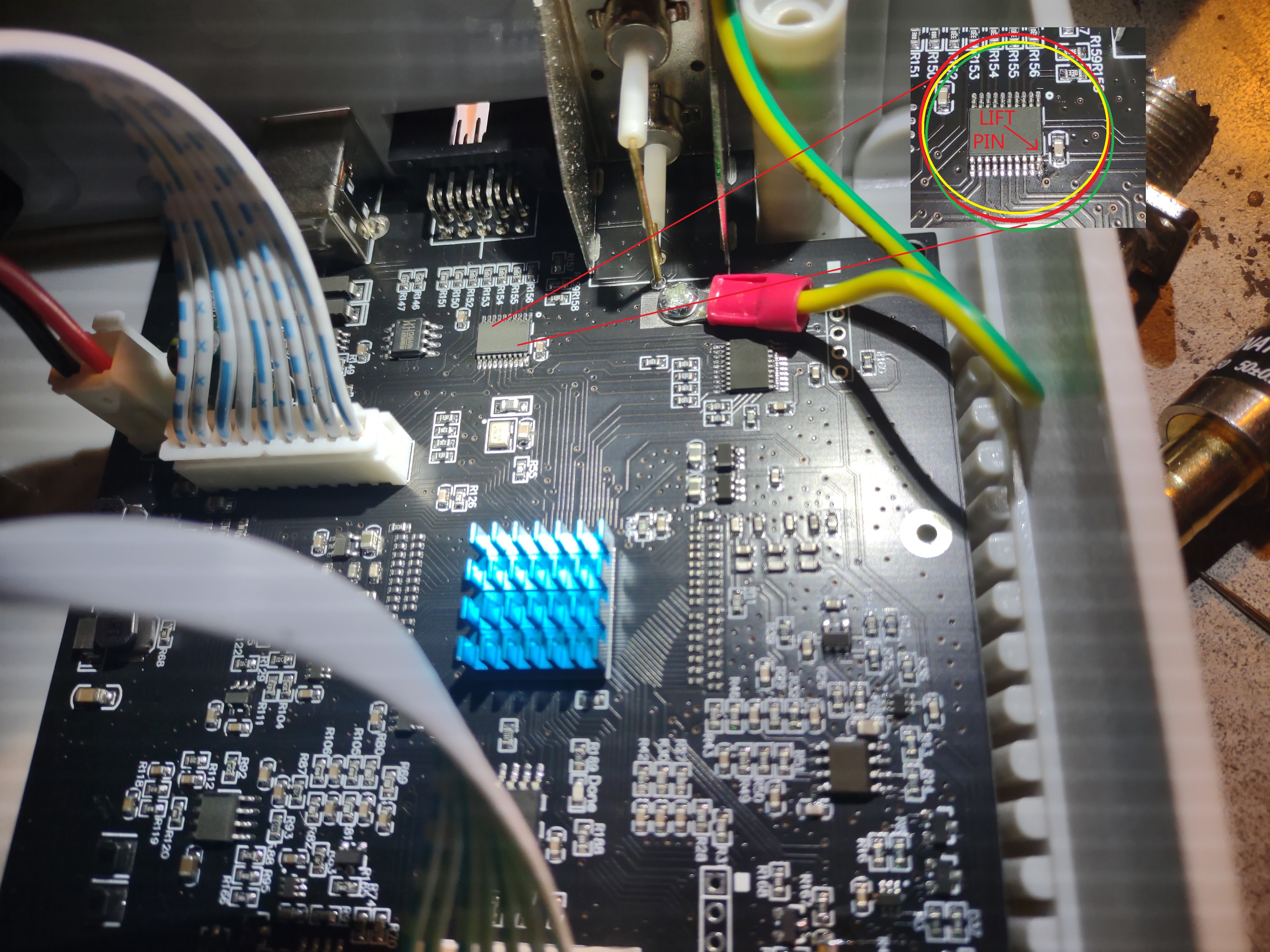

Of course, the labels on every IC, transistor and diode were lasered off. The chip those ports connect to is the same chip the TTL socket in back connects to and the traces are all right next to each other. Right now I am thinking this chip is an add-on feature that they couldn't make work before running out of project money and that lifting its Vcc pin won't shut the rest of the functions down (thats my hope anyhow).
...and sure enough, lifting that pin made all that crap disappear!!!!!! Now, when I adjust the generator to 27.384MHz and the outputs are still off, my radio on the bench picks up nothing. And when I turn on the channel, it still puts out a signal.
That right there is a huge win! Now to make that ferrite internal.
