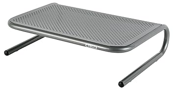

I recently discovered this stand on Amazon - Allsop Metal Art Jr - I put it in another post on the forum as I thought I had struck gold but apparently multiple members had already known about it :)
I can mount the radio on the top or below (it has holes so you can stick your mounting screws through the holes. Also they provide venting. Then I mounted fans (I guess you could either mount them above or below depending on where you mount the radio).
Nice thing about it is that I can mount a mobile radio + amp to it + fans + I can fit my switching power supply underneath and it keeps everything nice and organized.

Would that tray work for the 2970N series with the heatsink below the radio.? Just sit it on top of the tray without bracket? Also then I'd put the fans under the tray but fans also need space to suck air in, not sure how id locate fans to cool base of radio.
