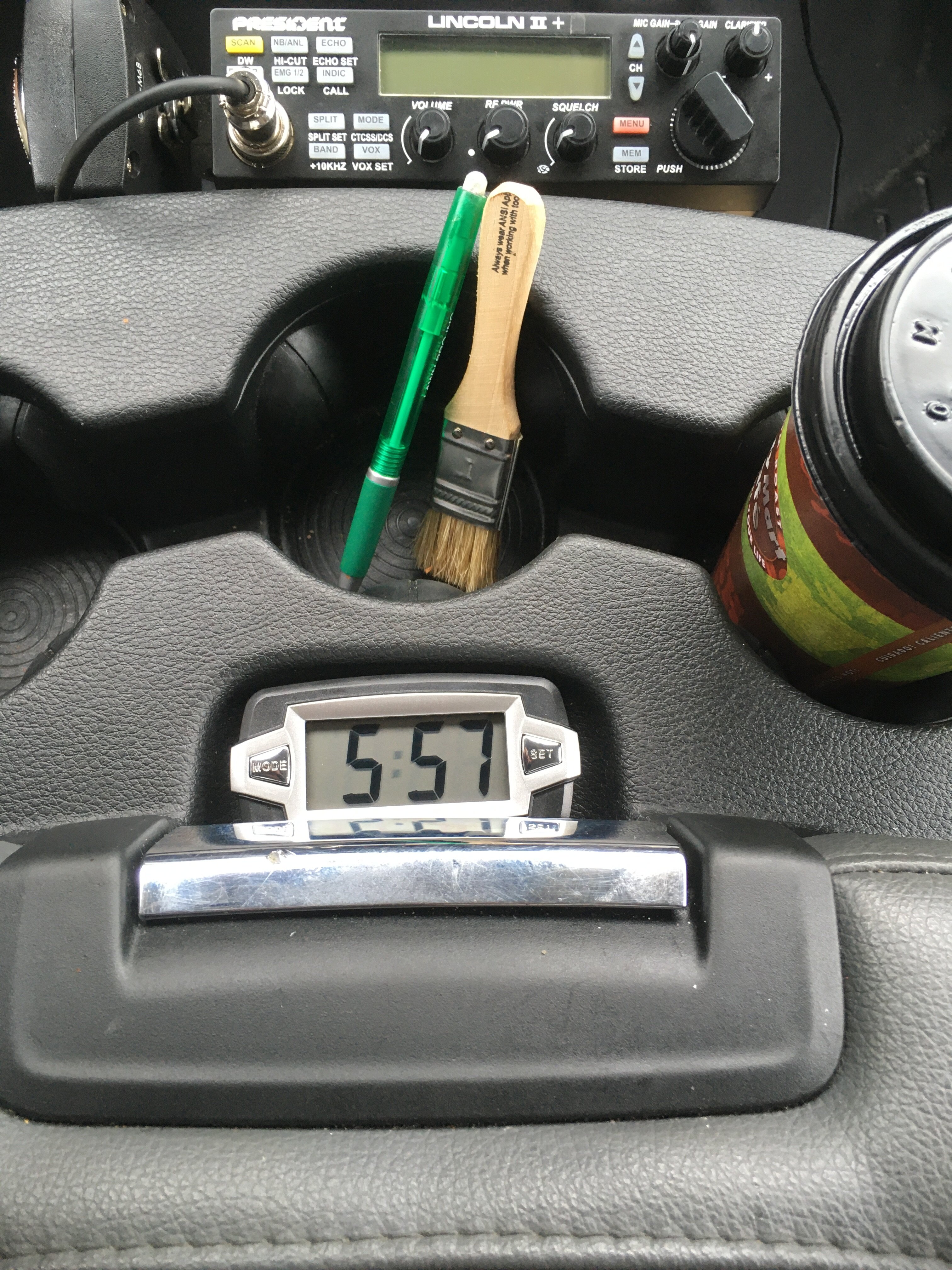

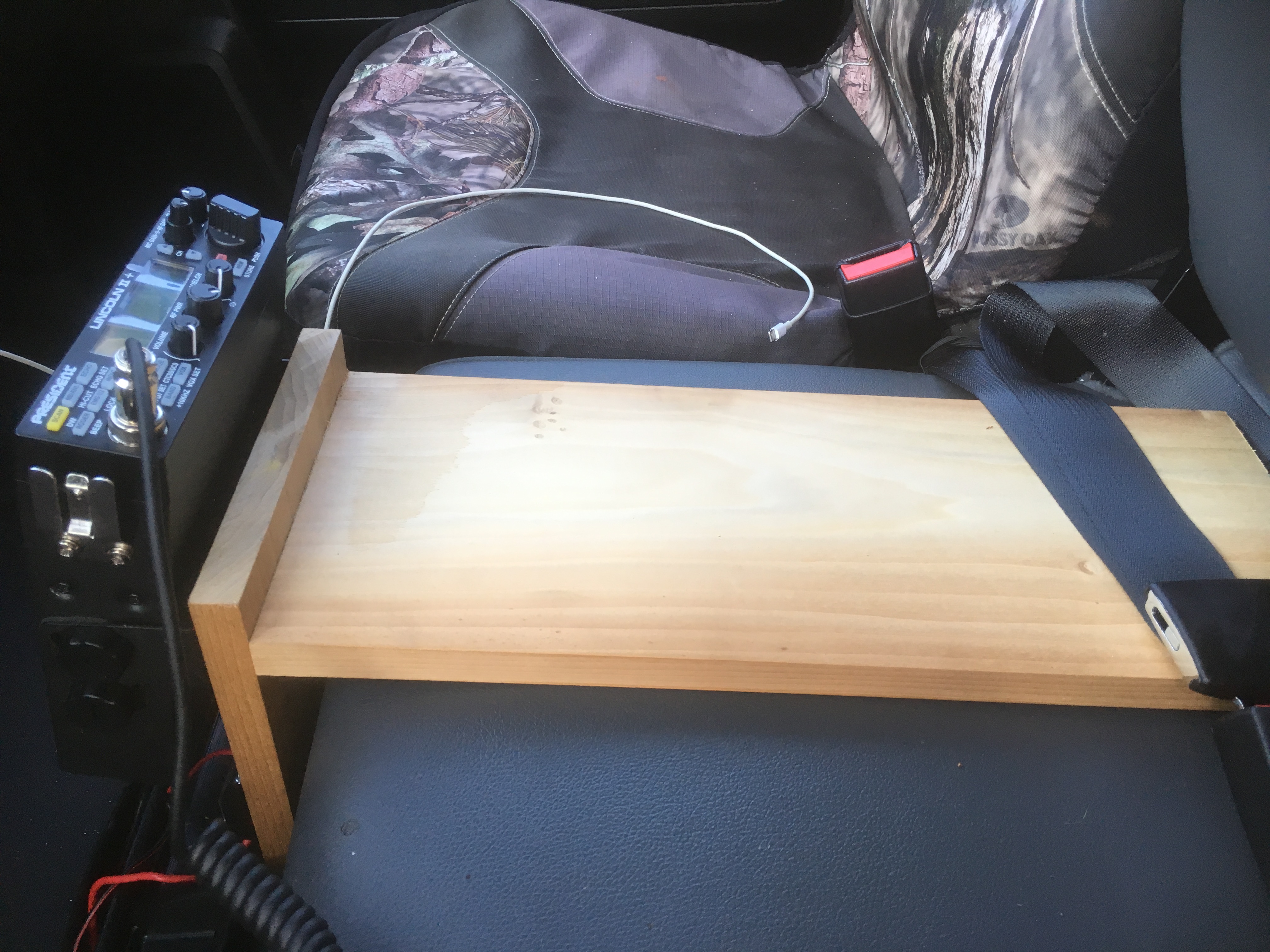

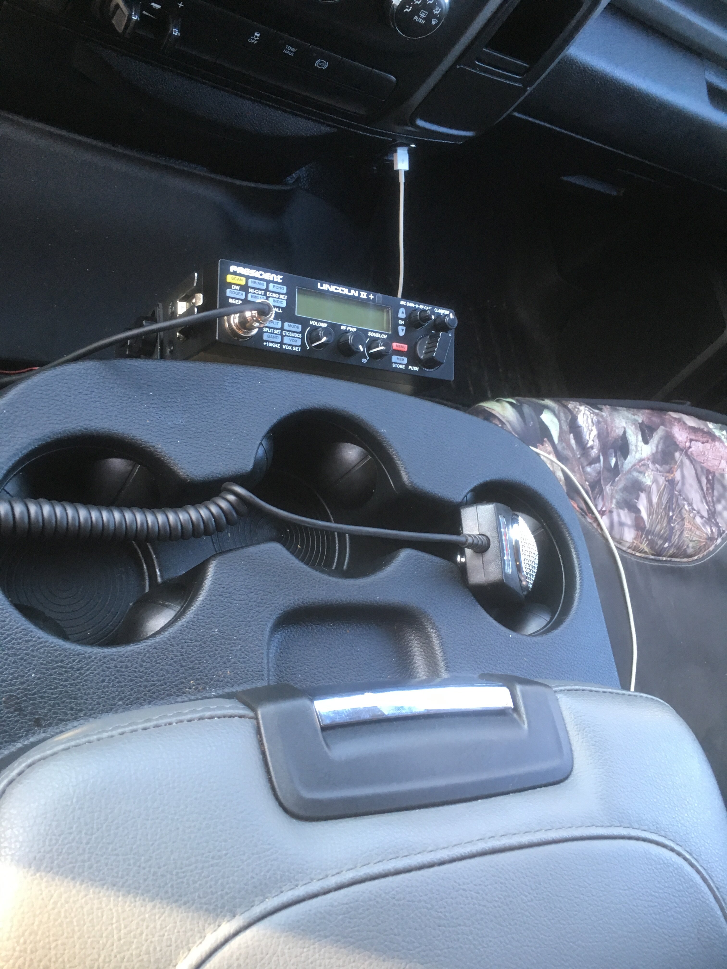

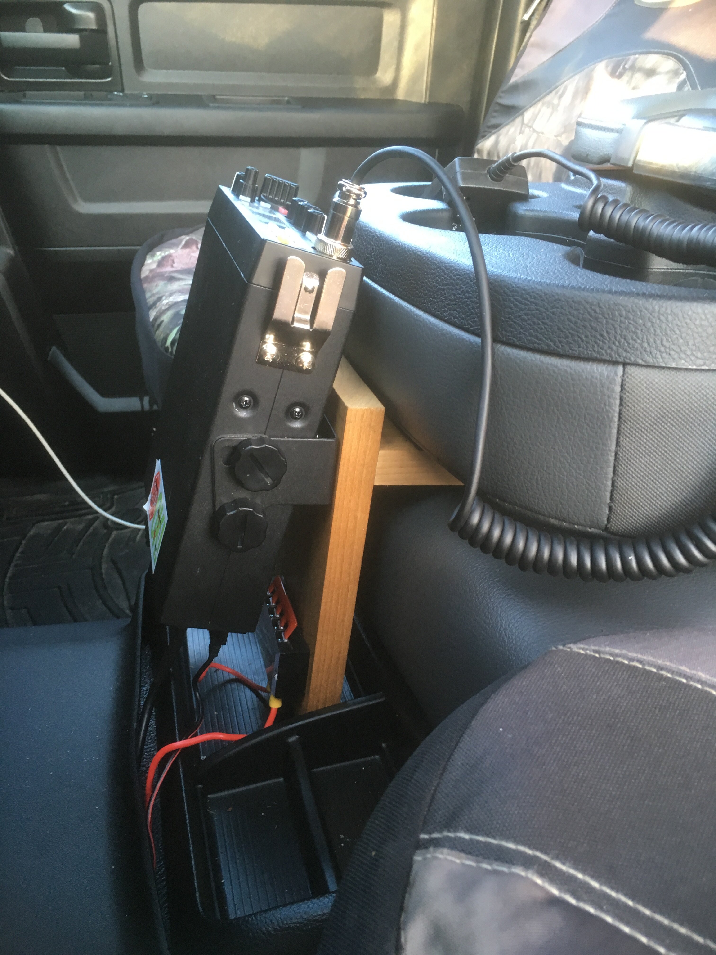

Here’s my quick setup for my 2018 Dodge. They just don’t make trucks radio friendly anymore, so I took advantage of the fold down bench seat.
I may round off some edges and wrap everything in vinyl just to help it blend in a bit...whole truck is vinyl anyway. Haha.

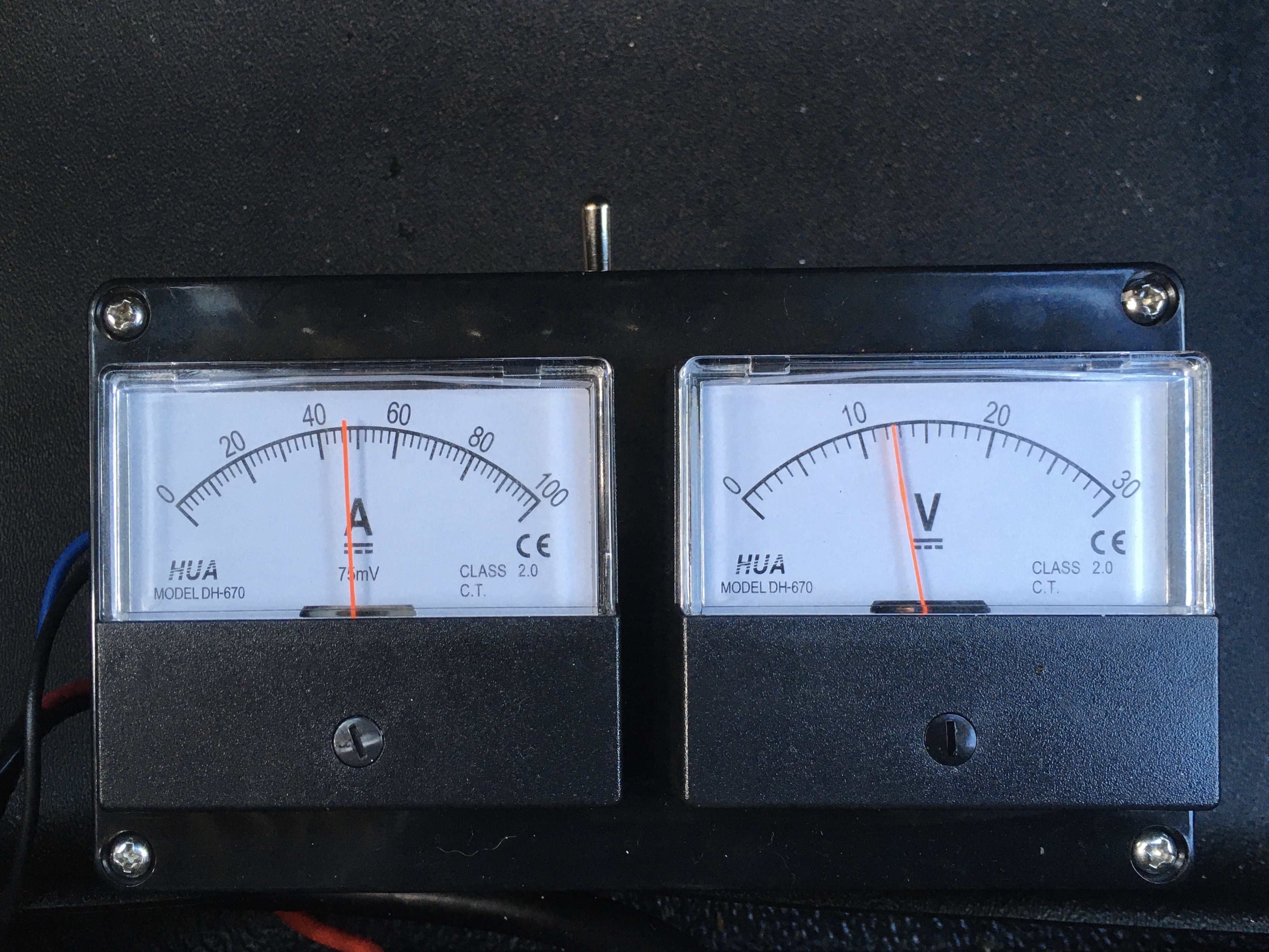

Mobile has been working great for me. Radio mount has been very secure. Added my DX500, but still haven’t drilled the roof. Will eventually. I have no reservations about drilling the holes, just have t felt like pulling the headliner.
I also added a ammeter and volt meter just for a feel good measure that everything is in working order.

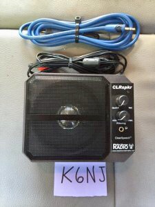

And, digital audio filtration
Don't leave home without it. Signals out there you presently can’t decipher. The radio can. Just not your ears.
WEST MOUNTAIN RADIO CLEARSPEAKER
See threads.
I use a ClearSpeech DSP Speaker or DSP Base Module on every radio I use that has SSB or AM.That includes my ICOM 7600 which has an Awesome built in DSP & it makes all of them better.I refuse to operate without them.I Hate Noise & these bad boys remove 99% of it for listening that is a Pleasure.Also I don't mount my UNIDEN 980SSB in my 2007 RAM 1500 Quad Cab.I simply slide it down between the drivers seat & the center console & plug in the ClearSpeech speaker & I'm off.
SIX-SHOOTER
SIX-SHOOTER
The more I hear the more I want one. There’s been more than a few times I could hear my call sign but missed a contact because the other station was just below the QRM.
