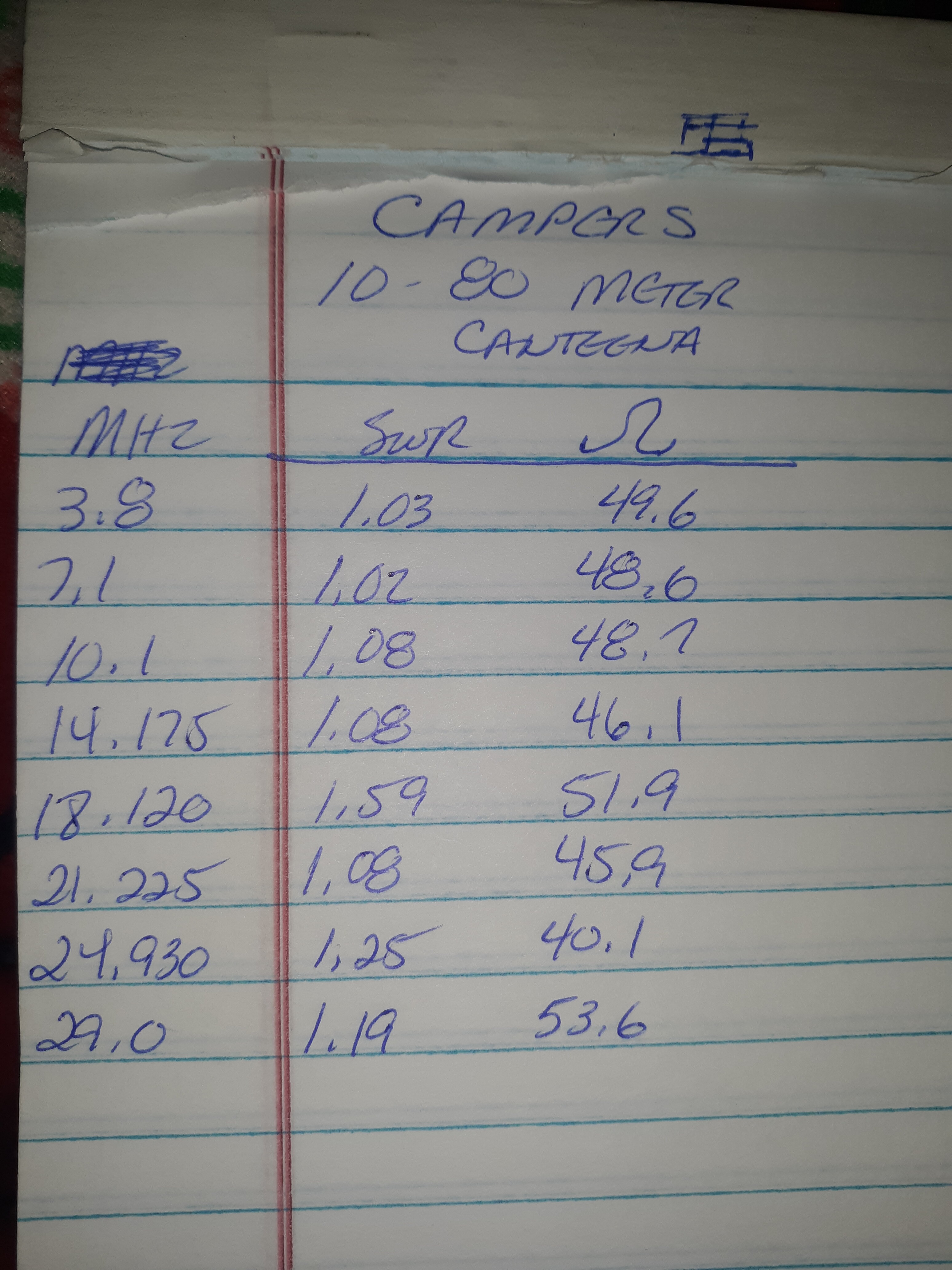

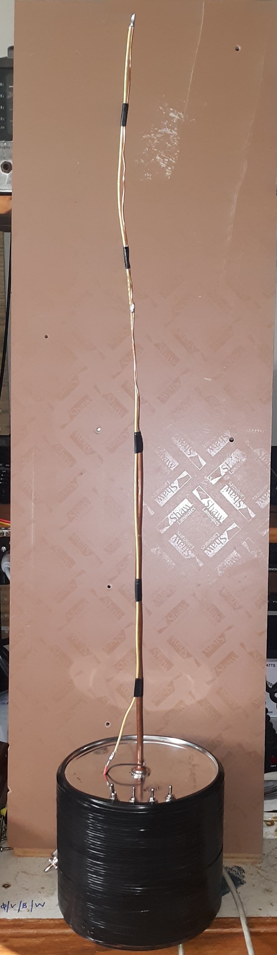

33 inces tall. 8 wide at base. Coil switched. Covers 10 to 80 meters. See pics. I recorded swr but didnt record for X, it was not bad. It's a prototype. Indoors sitting next to me under a metal roof it has decent ears, all things considered.

Construction details?

I've not used it yet. Snow, mud, work.....I'm gonna just ain't. Itll be bad if it burns! Cardboard coffee can. #16thhn. 3 seperate coils. 6 tails. 4 switches. I didnt count wraps. Figured if it worked.id take it apart
