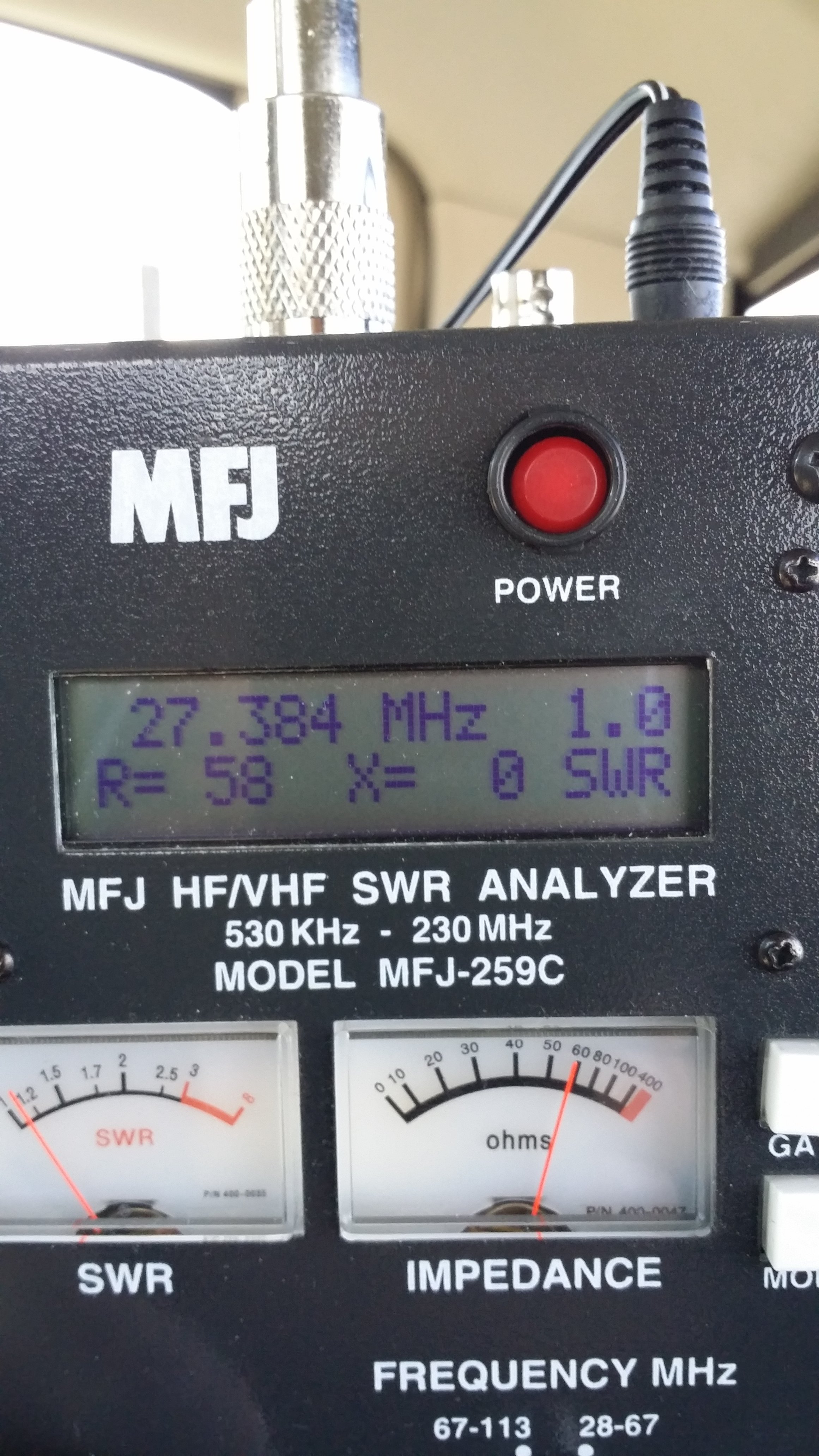

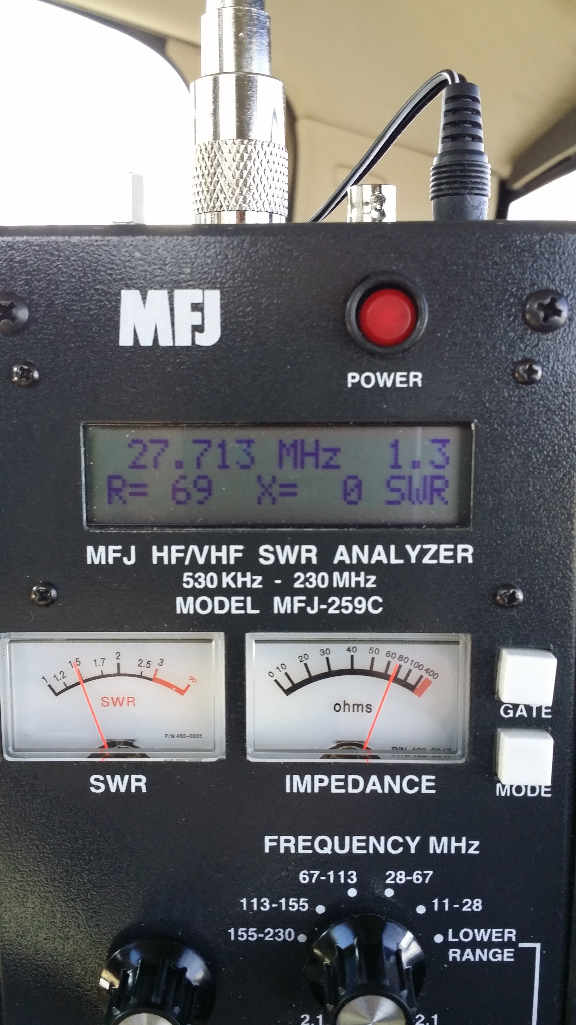

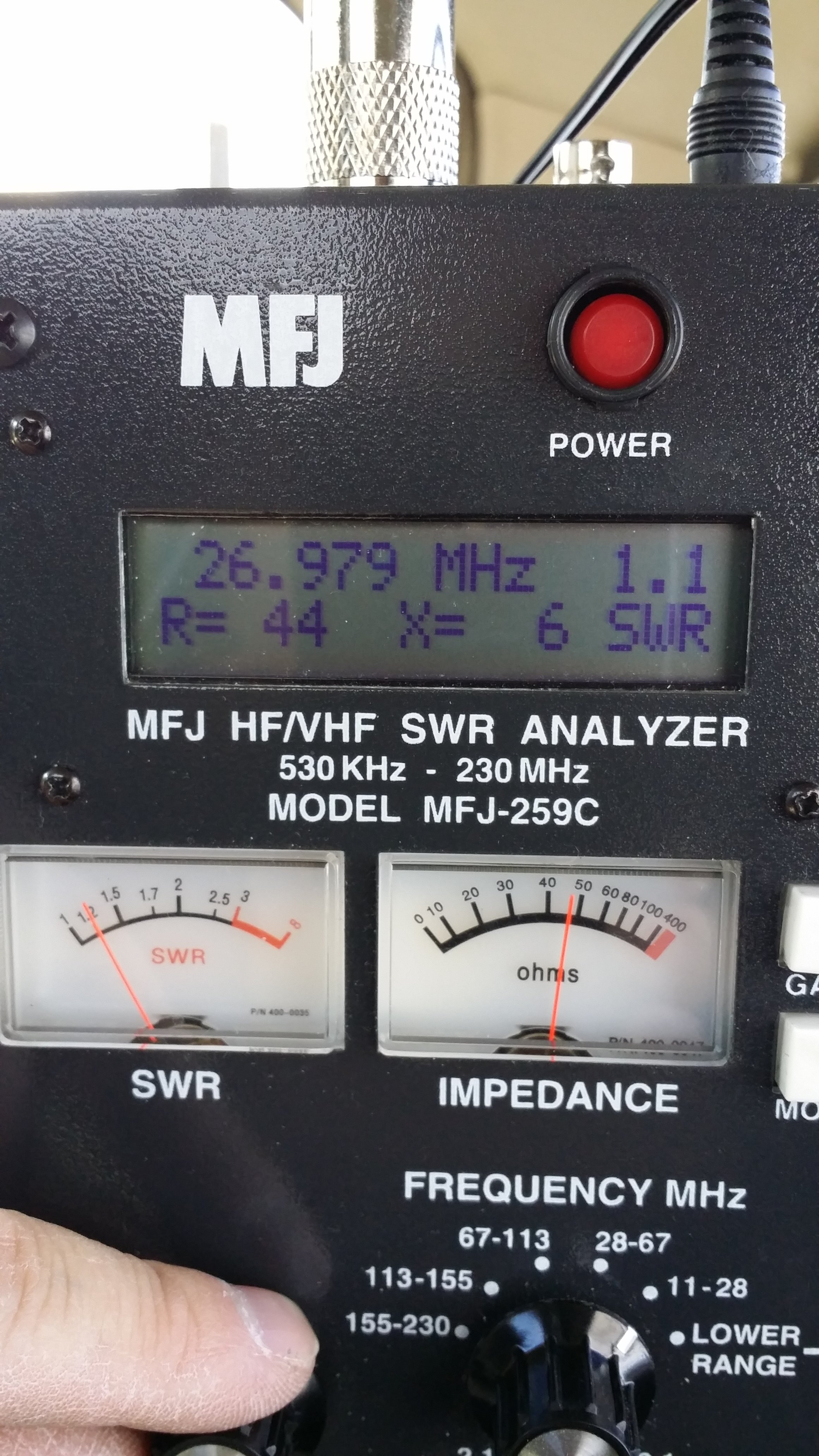

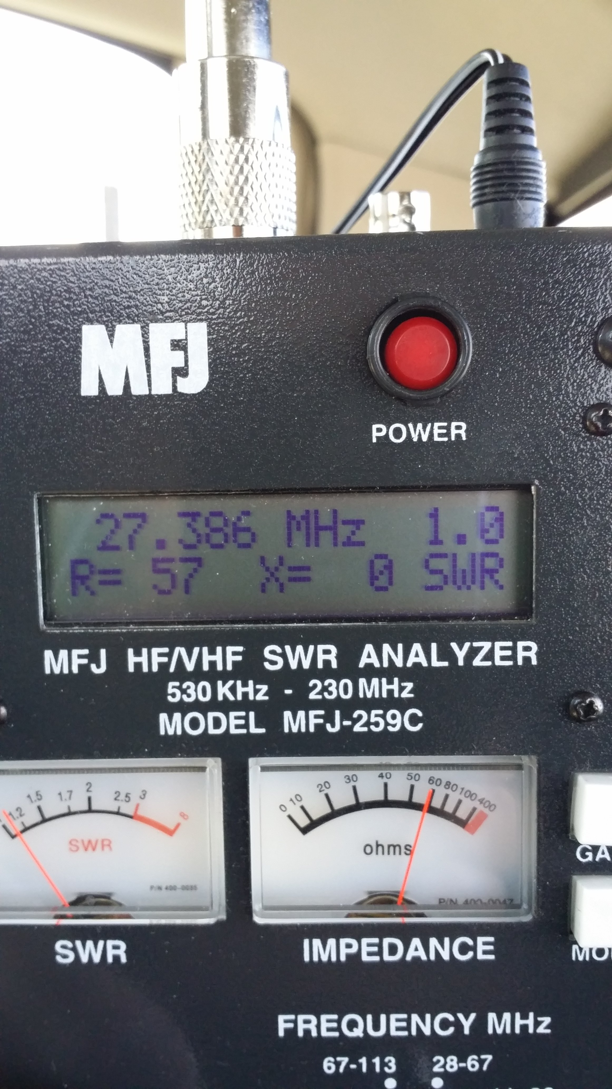

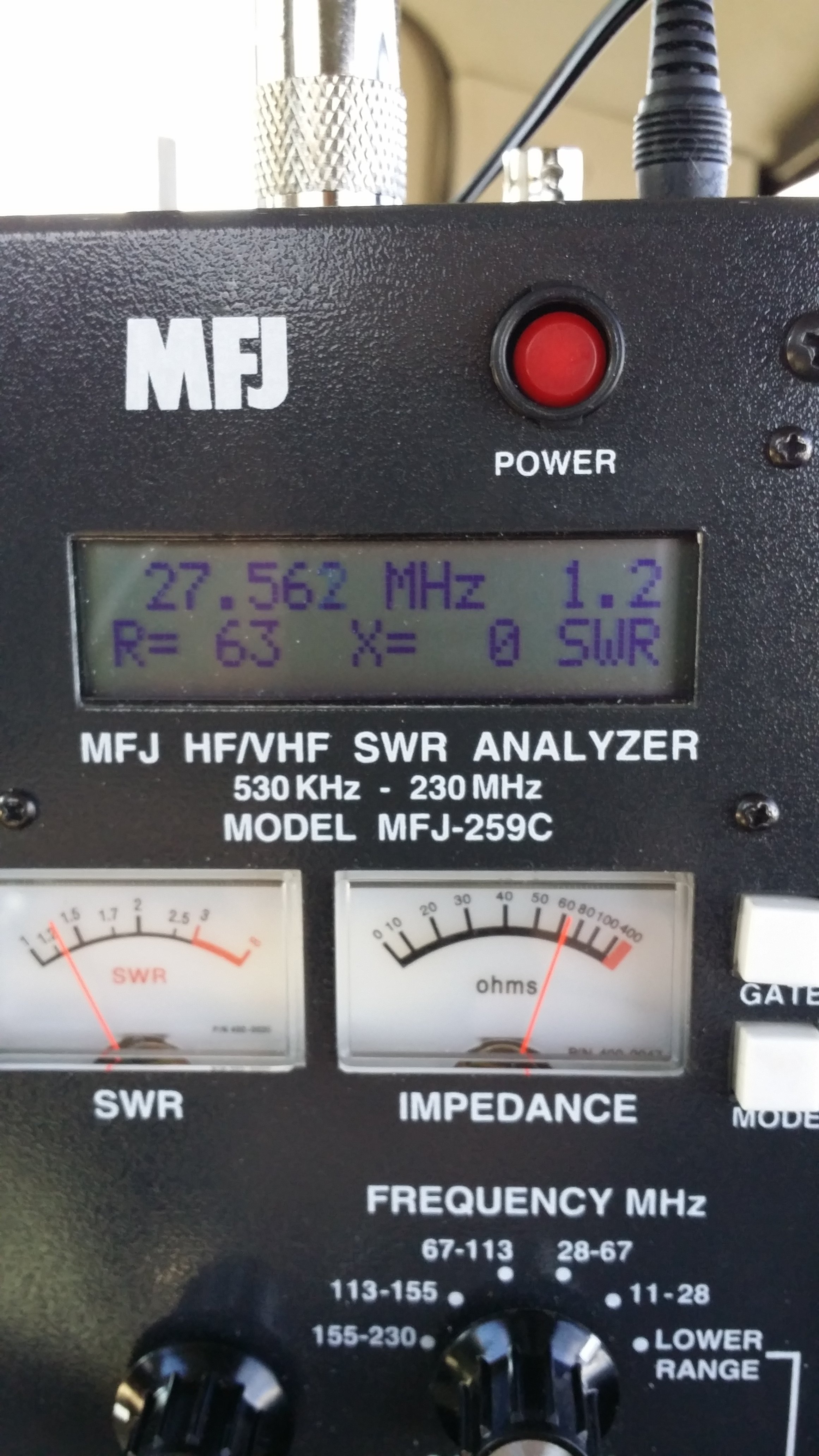

As it is right now, my Delta loop antenna is: 1:0, 1:1, .365 to about .557 on 11 meters, it all kind of depends on if I'm set up on sand or dirt, wet or dry, snow or what ever, I know you know what I'm say'en. The worst I have ever seen was 1.3 but I was way out on .885, and around 26.455 around 1.4.
With my sirio 5000 I'm flat pretty much any place on "cb", I just want to use the at-1000p2 to keep things flat to keep the amp nice.

The photos are from my mobile set up. I have no photos at this time with the Delta loop.
