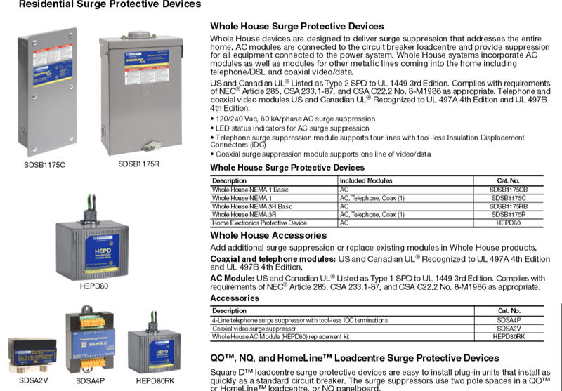

Whew! Speculation. I thought you had something concrete and I would have buyers remorse. In a brief search, I did find a Amazon vendor selling individual modules (no price). I did not find anything on eBay. I have not looked deep enough to see if I can easily crack open the modules to get to the juicy innards.
You may have something on the discounted price, I just haven't found it yet. It may be just like buying an inkjet printer, they get you on the consumables. Although, I won't be consuming these modules on a regular basis.
