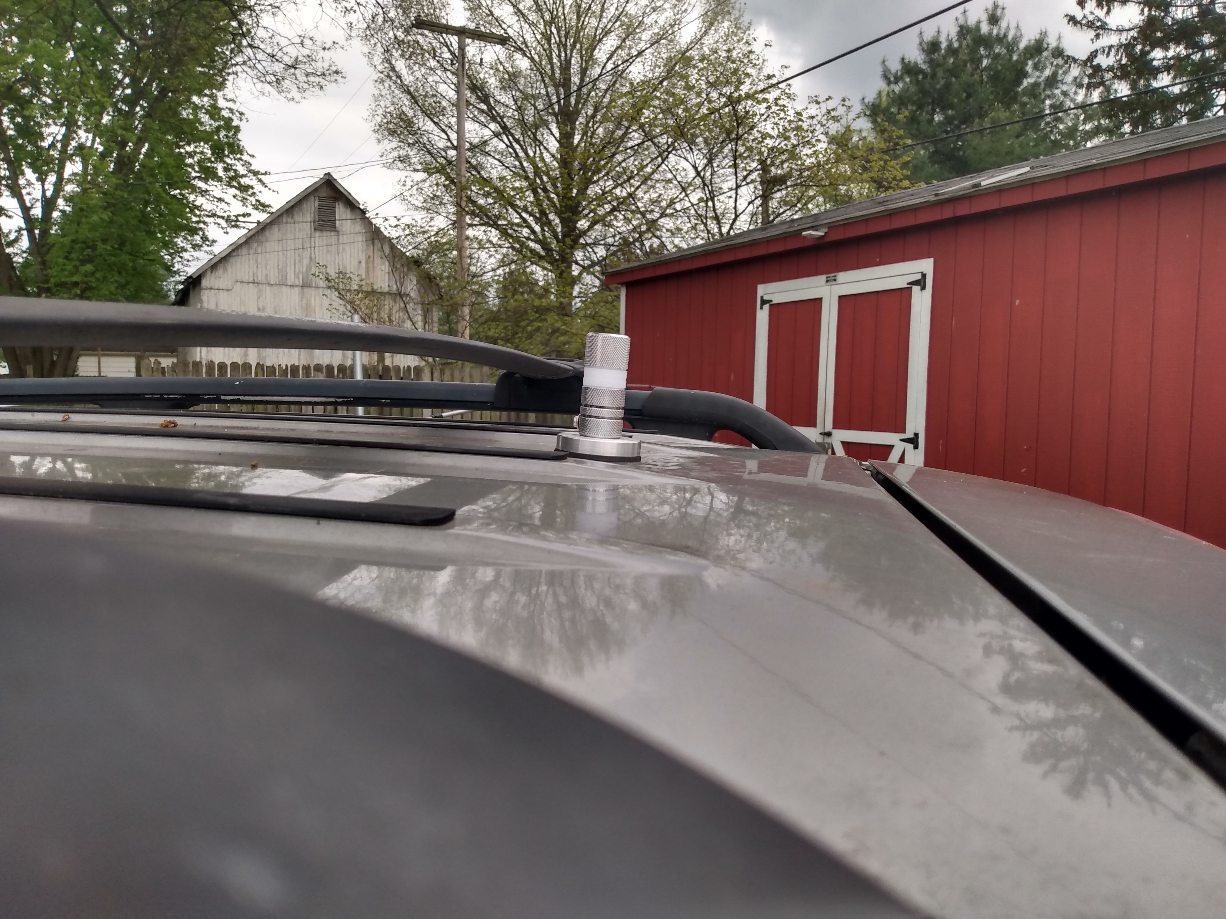

I got my Breedlove UHF mount with Comet stud adapter. I'm all ready to mount the Tarheel. I also ordered a Tunematic Lite controller.
