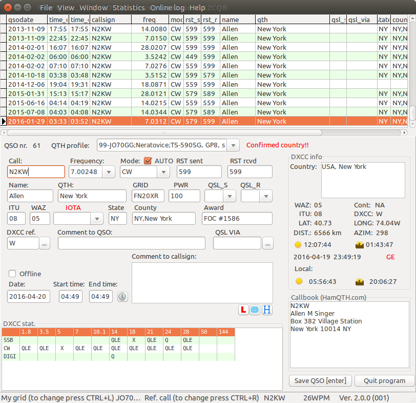

I use CQRlog and import and export to EQSL and LOTW.
