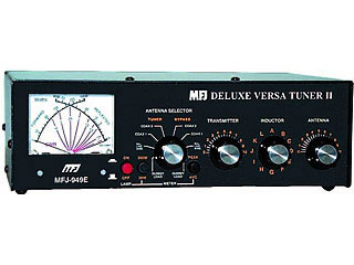

Klondike Mike has a good deal on an older version of the MFJ-949E. The Dentrons are nice if you can find one.
I have a 949e and I think it's a rock solid manual tuner. I would suggest a newer version because the power meter is updated with a cross needle type and needs no pre-calibration.
These tuners are rated up to 300 watts, they have a handy dummy load built in along with a 4:1 balun for wire antennas.
Shop around because they can be had new for $150.

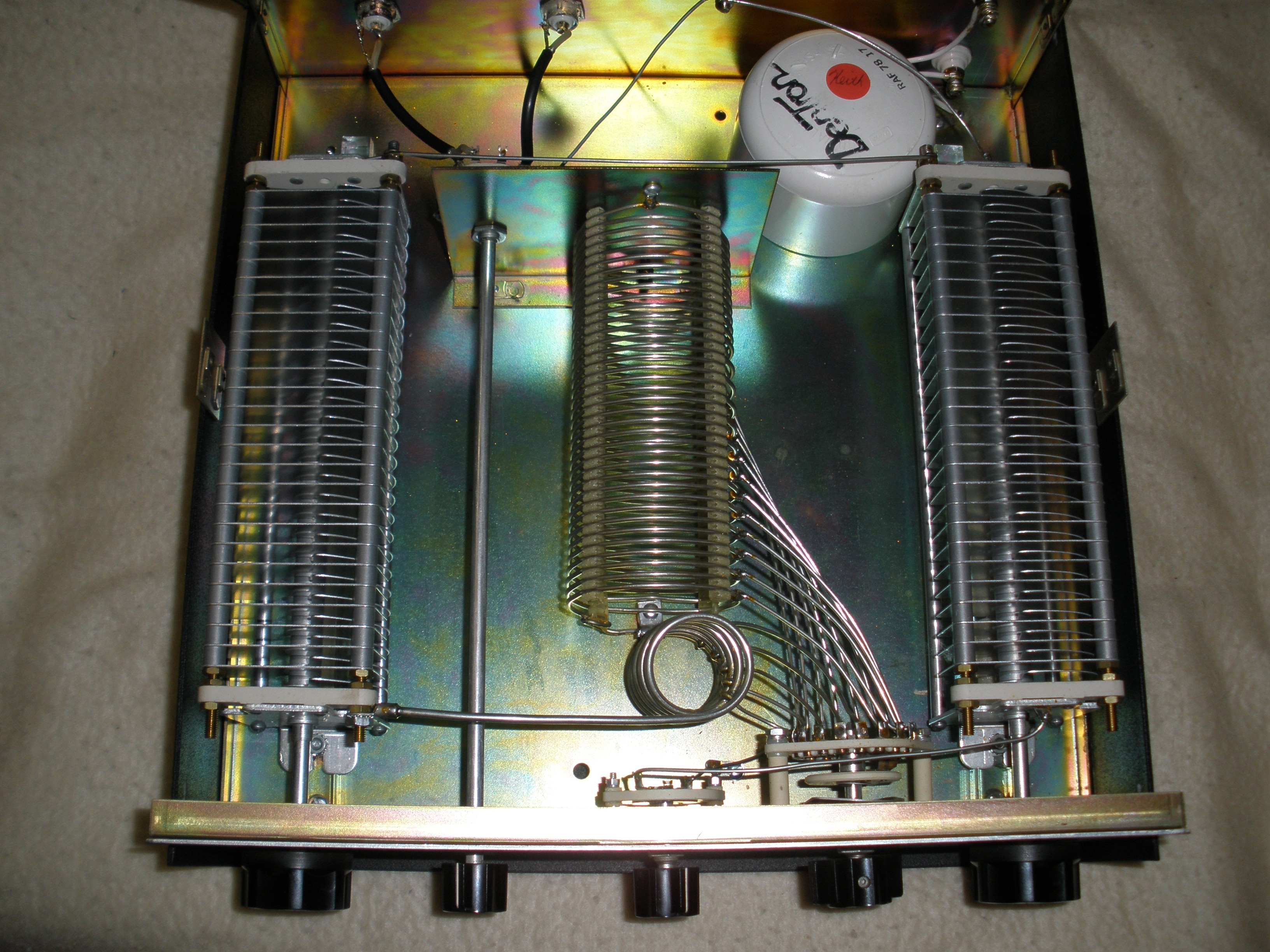

ANTETUNE - Dentron G:T-1000C antenna tuner
Great condition and great working Dentron 1000C,1000 Watt antenna tuner. Asking $150.00 plus shipping. Payment via paypal.

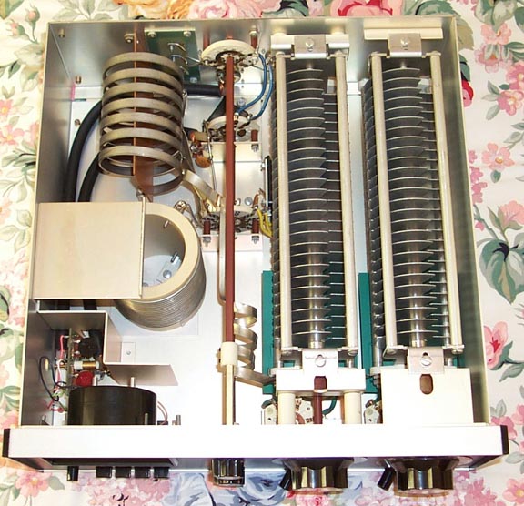

Inside view from stock on-line picture
Putting a balun on the output of an unbalanced tuner works. Many people do this and are satisfied but better performance can be had.
If you want to feed balanced line the Johnson Viking matchbox is a true balanced tuner. It is link coupled and can be found at a hamfest for under your budget.
