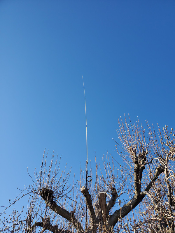

My Imax 2000 the other day....40MPH winds plus gusts. That's a 21ft long 2" diameter pole bending...
You'll notice the ground plane kit. The box directly under the antenna is a RF choke which you can't see that well is made from a FT240-43 toroid and put in a nice plastic box. Really must make another with a FT240-61 for 10/11m. It connectes to the antenna with a male to male PL259 adapter so there's effectively a direct connection between the choke and the antenna, no coax.
A well set up IMAX2K. Any thoughts on how that with the ground plane kit compares to a Gain master, I know you have used one before. Very similar I would have thought with the benefit of use on other bands.
I never quite got on with the IMAX, I am sure if I had it set up like yours it would be fine. I found a difficult to SWR in (even with an MJF 1:1 balun/choke), heavy, and a GP kit was a no go.. (static mobile). And it also made the radio's self noise floor higher compared to the gain master, subtly but noticeably and I don't think it was because it was RX better.
Still in the loft and I am very pleased to say its value has appreciated. I paid £88.00 in 2015 and now they cost £170.00 where it is in stock. I will keep it and you just never know I may even need it one day.(y) It won't rot in the loft.
