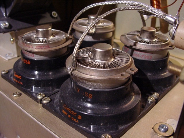

When the amp was acquired it came with a bag with four resistors in it. I was told these were soldered to the tube clamps, all four tied together and a single lead went to a door knob capaciator. The resistors are 10 ohm, 5% carbon composition resistors. Not sure what the watt rating is, thinking it may be 2-5 watt rating. The resistors have a single wire wrapping three times around the resistors and soldered on both ends. What is the reason for this and is this a shunt resistor as someonen else mentioned? Looking at the resistors, they have been overheated pretty bad and I guess the guy who had it was going to replace them.

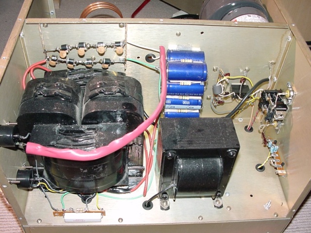

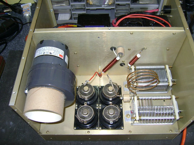

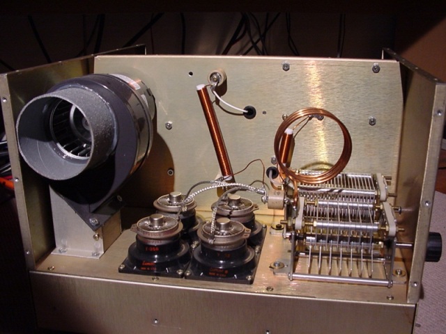

I searched the web for pictures of the amp and found some which I will include. The amp I found on the web does not use the resistors from the tube clamps to the door knob capactor. It is a solid braid lead from each tube to the capaciator. What is the impact or reason for removing the resistors? With this damage the amp not having this protection?

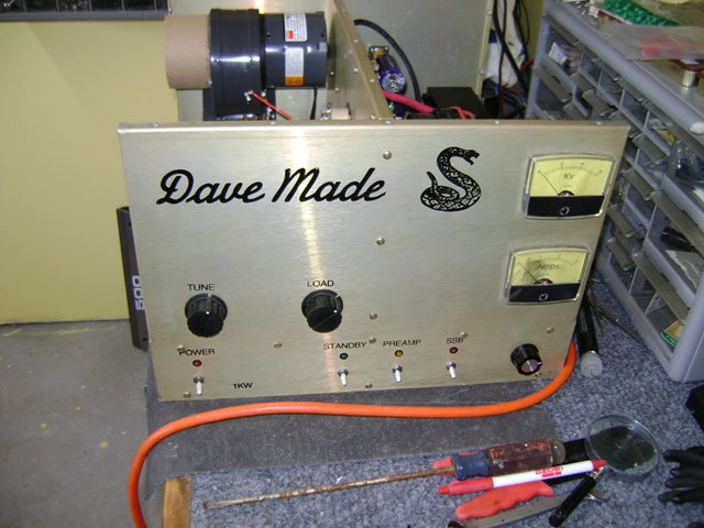

The amp have two meters on the front, one is a KV meter and the other is a AMP meter. The knob on the bottom right is the bias control. Which meter is to be adjust, the AMP or KV meter? Now looking at the face of the meter, it suggest that these are not premium grade meters so I assume accuracy is not the greatest. There are a couple setting to set the bias to, between -35 to -50 (is this per tube?) or -400 (all four combined -100 per tube)? Your thoughts. KV Volts read at 2100 to 2200.

The 4 or 5 watt carrier drive says tetrode but the pictures say triode. I don't see any signs of a screen supply, neutralization, or screen regulator. There is the slightest chance there could be a screen winding on one of those transformers with the rectifiers and filter caps on the bottom but I doubt it.
The resistors with the coil around them are called parasitic suppressors. They help stabilize the amplifier so it's more resistant to oscillations. Some of which can be destructive to the tubes. It's a smart idea to include them on this tube at this frequency. The resistors are usually 33 to 100 ohms at 2 watts, carbon.
The bias should be set to the amp meter. I recommend 200 milliamps or less for the total four tubes. This is 0.2 amps set with the relay keyed and no drive applied. This is around class B and probably going to be your safest bet. Class AB1 would be 0.4 amps for all four tubes total and that might be risky.

The design of the parasitic suppressor is dependant on the tube used and the frequency used. I would think 47 ohms with 3 or 4 turn of # 16 wire loosely wrapped should work in this application. Getting the wire right is more important then the resistance as long as the value is between 33 and 100 ohms. The selection of 2 watt carbon resistors is very limited today. You might need eBay for this.
