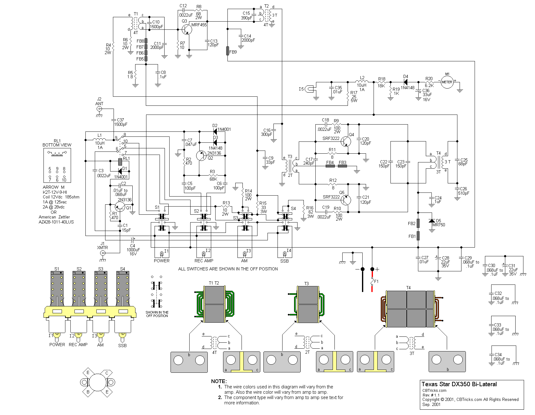

Schematic from CBTricks. I don't see any AB bias circuitry in this schematic, just a switch that adds some delay to the relay. Unless I have the wrong schematic, that's class C correction: class B.
Edit: you can tell by the transistor's bases. They are tied together. Class AB has circuitry to provide about 1.2v between the bases so that they are both on the verge of turning on to limit crossover distortion.
Edit: class C would be with the transistors in parallel turning on at the same time...

Thanks for the schematic Brandon ! That's pretty much what I suspected......
The 455 driver is properly biased but not the two SRF3222's. So they kind of did it half-right......:rolleyes:

That is a schematic of a old Texas star bi lateral amp that used a mrf455 driver, that design went away a long time ago.

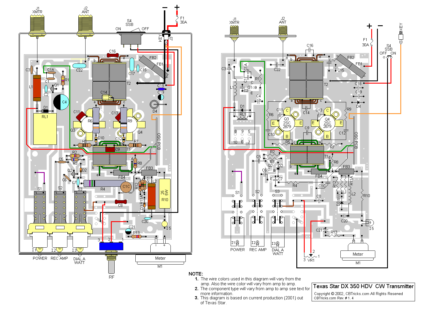

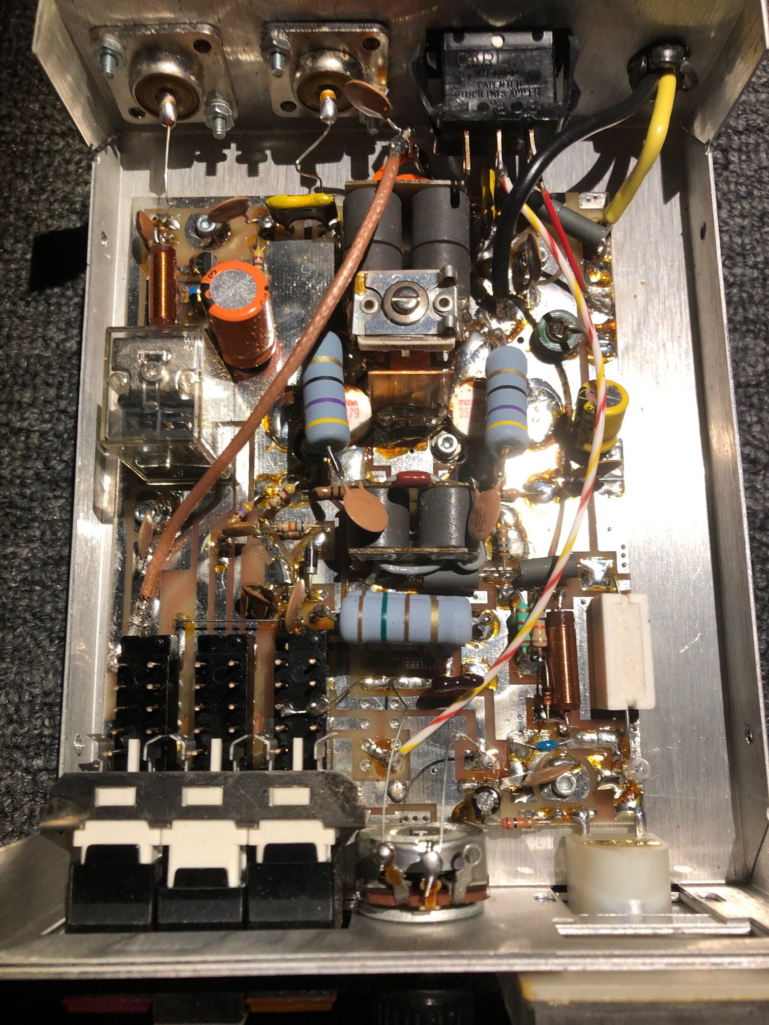

See attached photos
The bias network is right behind the meter.
You can see is not regulated bias like the TX line of amps were, its fixed so changes in input voltage can effect it, its not the best design but it works.
As long as you feed it with about 14 volts, dont drive the snot out of it and put a fan on it they are good amps.

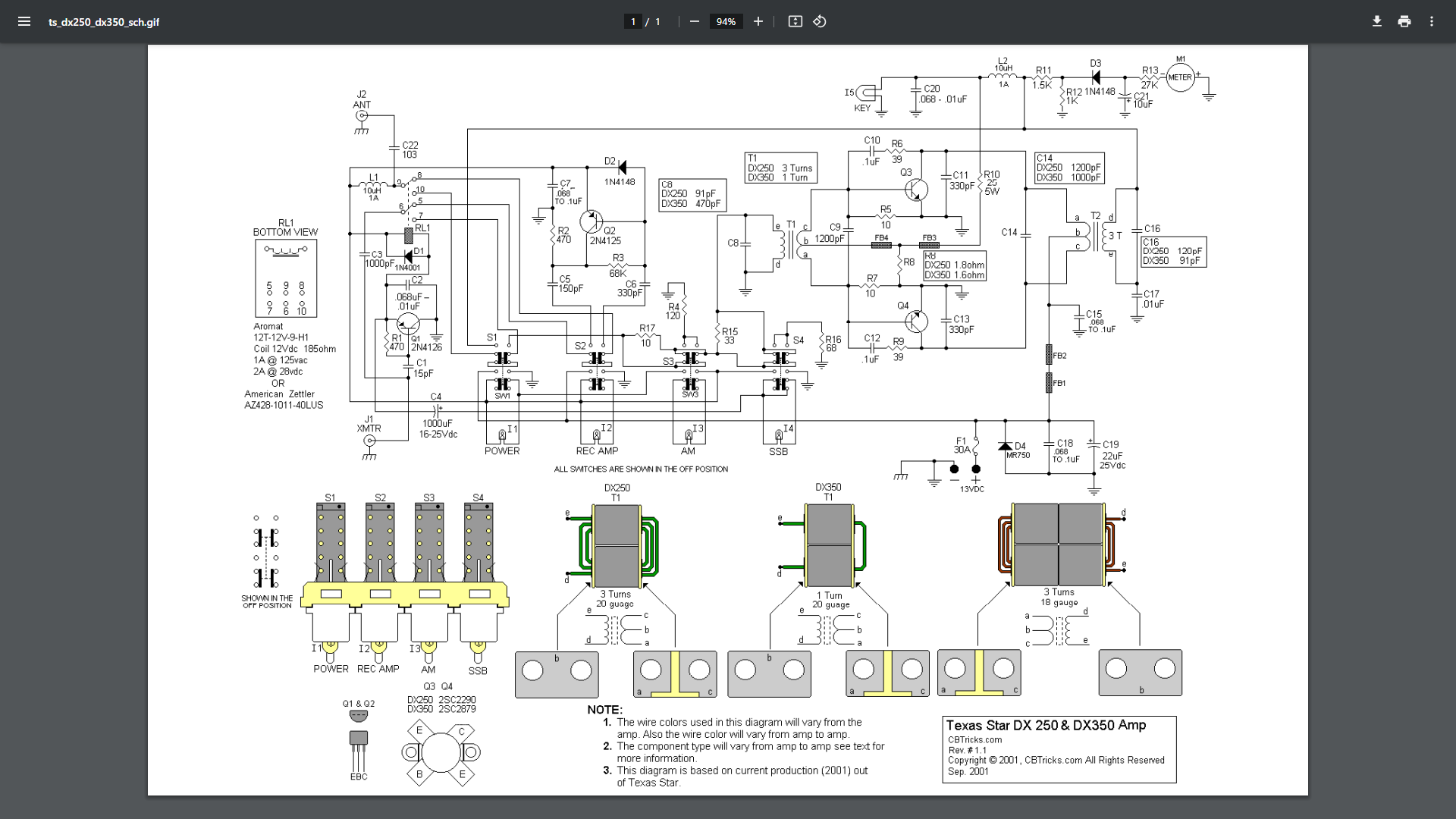

What schematic is that? That's no DX350 that I've ever seen.
This is a standard DX350 with 2 2SC2879 transistors.
Reactions: BC Coyote
