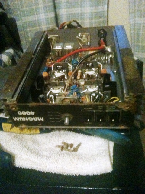

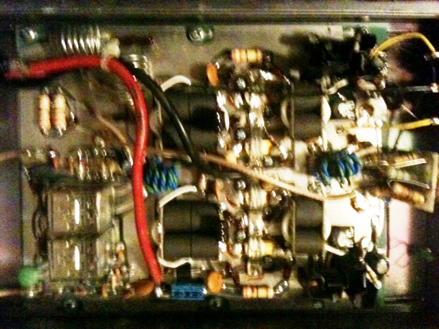

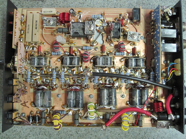

If you get time, snap a picture of the inside of that amp ( and the M4V ) and post it, not many people have seen the inside of those.
Jeff
[/ATTACH][/ATTACH] This is some poor pics of the Magnum 4000. The outside looks like it had been through a war but the inside looks real clean..It works very well. My Penetrator 500 is at 36' and about 30' from my neighbor's house with no issues. :wink:

Thanks, And I thought the 4000 was a 6000, MRF 454`s in that one I think, and if you do not over drive them they should continue to last.
I had a 6000 and I let someone talk me out of it.....:sad:
Jeff
Your right! I had a brain fart in my other post and said it was a 6000. :blushing:
Wishful thinking I guess!
The 4000 does well though. I can't tell what pills are in it because the ground strap has them covered!

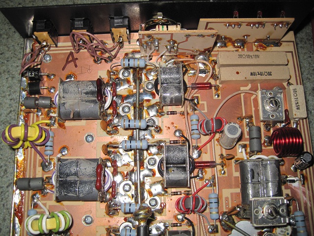

That was how they built them, the 6000 was the same way.
The Later M4V with the 1446`s in them used a copper strip over the transistors instead of the solid wire.
This was to ensure they had a good ground because of the strip -line style of boards.
Jeff

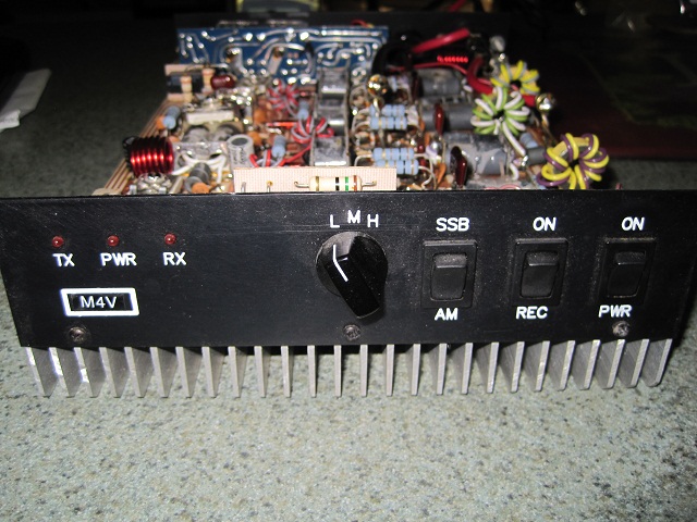

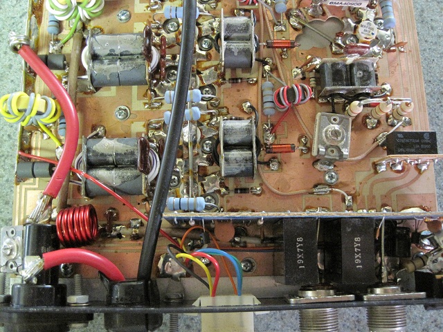

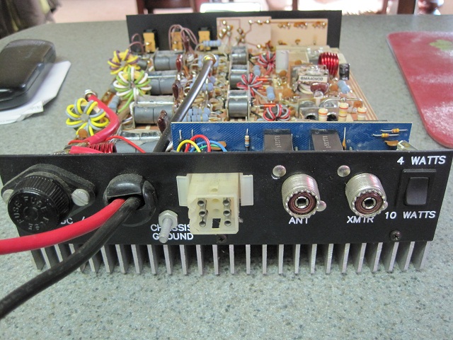

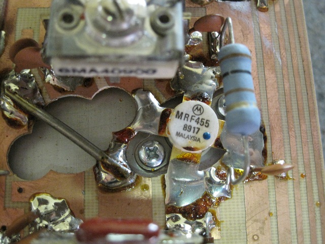

You can't tell by the pics of the M4V but it has both the copper strap and the heavy rod over the pills-impressive!!!
Another thing that bothers me with this amp, is that it doesn't have a fan! By the sounds of it, it could use one.
