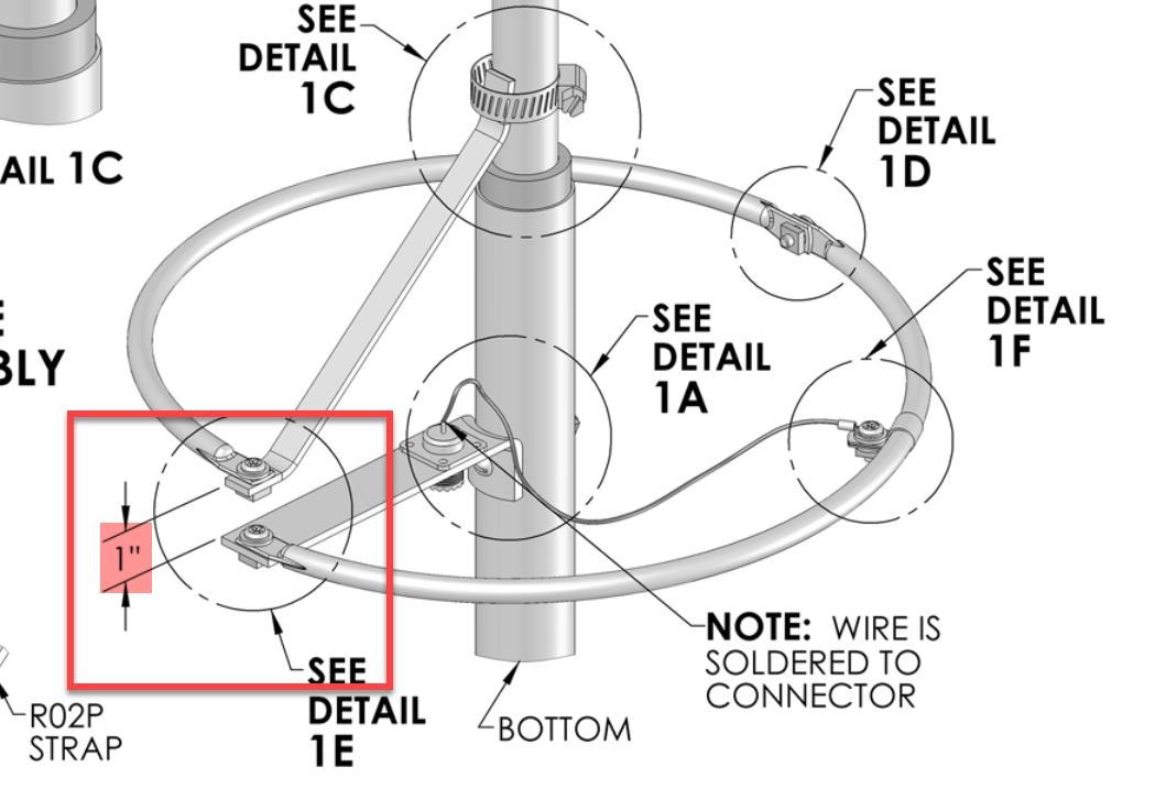

Hi,
http://antennapartsoutlet.com/files/MACO_V5000.pdf
The Maco has several critical measurements for SWR. You will never get them set by adjusting only the vertical.
