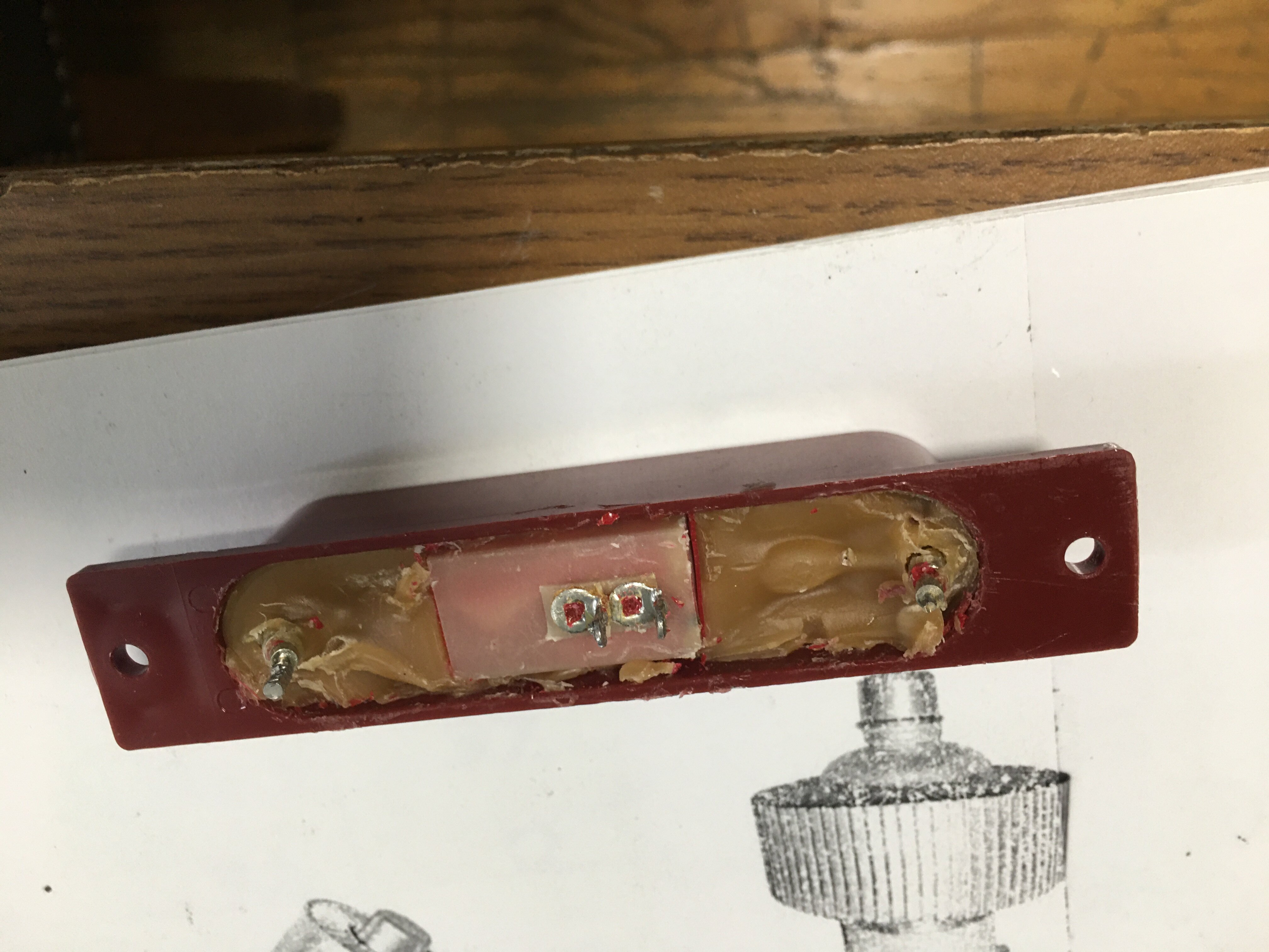

The Magnecraft reed-relay (SPST) I had between HVPS and plate choke began to stick. Thankfully, a safety habit of 'discharge before touching' paid off with only a frightful bang! Autopsy to look inside relay: 2 flat metal strips in a glass tube (non-vacuum) passing through a coil -all covered in wax- in a plastic case. I'm surprised it lasted as long as it did given it's low 2-digit current rating. Another learning experience & now it's onward to a proper vacuum relay.

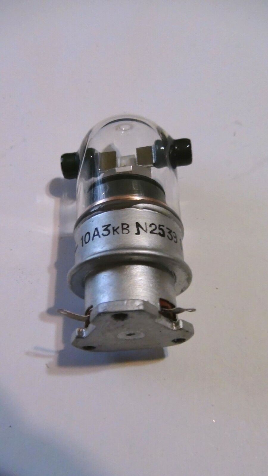

I ordered the cheapest but new SPST vacuum switch I could find: A Soviet relay rated for 10A, needs 22vdc to keep closed so it should substitute without a fuss. About 2" tall pic attached if I can upload. I like the G3SEK circuit that opens a relay disconnecting HV to RF deck when a fault is detected. I placed it between HVPS and plate choke. I do recognize DC is hard on relay contacts. The relay stays closed after warm-up, rather than opening & closing with each T-R cycle. If placed in an AC line it would be either: pre-FWB or on the primary side of Plate Transformer. Both those locations would conflict with the Soft-Start. I found this decision process confusing and I'm still not certain about it. Relay location was more of a default but the Magnecraft did work well in same location for awhile. Only remaining option I can see is not using the circuit at all.

Breaking a hot circuit draws an arc across the gap between the contact points as they draw apart. Usual strategy is bigger contact points. Some vacuum relays are characterized for breaking a hot circuit, and others are not. Finding original specs for russky relays might or might not be possible. And interpreting them to determine what sort of service they're meant for is not my specialty.
I do remember finding that vacuum relays designed only to break a low-current/voltage circuit was cheaper than one characterized for hot switching. A vacuum relay won't make a bright oxy/nitrogen arc when it breaks a circuit, but if it's not meant for hot switching, that service won't be kind to it.
Oh, and linearone, this relay isn't being used for transmit/receive switching like they do in a D&A amplifier. This is a fault-protection circuit. Should not get activated all that often, but serves to protect components from fault surge currents.
