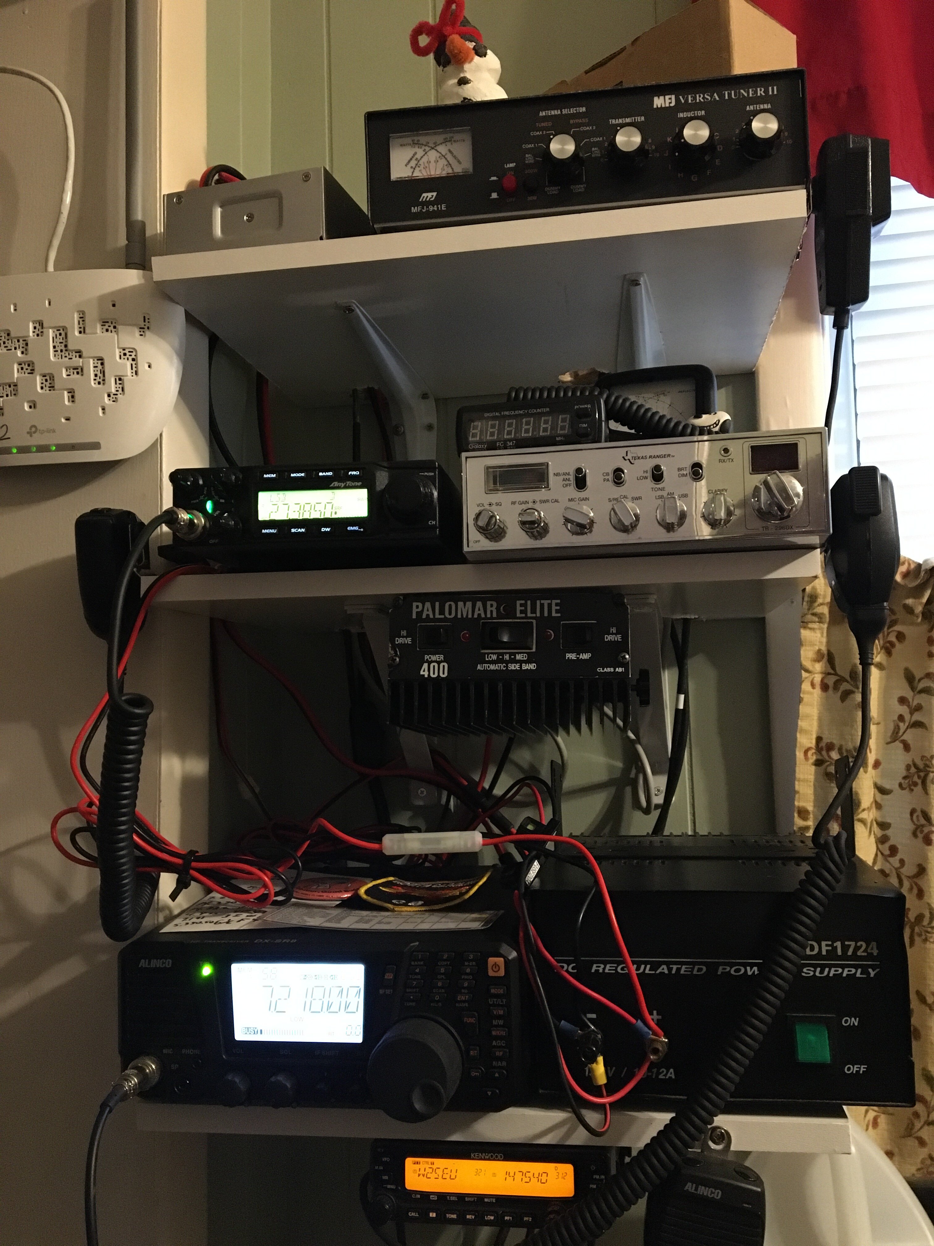

Anytime I'm talking on my AT-6666 set up as a base radio I'm using two of the S-400-12 PS's...one to run the radio and one to run a two-transistor amp.
Bottom left corner of picture. (y)

Thinking of moving my 10-12 amp (DF1724) big old power supply to the shed in NC to go with the rig I'm going to leave there and ordering another S400-12 (tip left in pic) to replace it (I have one in use for my HF rig and my 4 pill). Smaller is better when working with tight shelves that I have currently. DF1724 on bottom right next to the Alinco HF. Also be nice to lose the front power wires that are sitting there.
BTW, lookin like a nice setup! (y)
