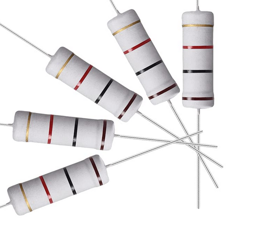

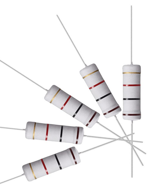

Anyone ever used these metal oxide (flame proof) resistors in a mineral-oil type of dummy load?
I've used this type of resistor in simple dummy loads, but never in one that's been submerged in oil.
While foraging around in my boneyard of parts, I found some copper pc-board and several of these 1k, 5 watt resistors and thought about making a larger dummy load and put it in a 1-quart or 1-gallon can and fill it with mineral oil. I think I have enough to make a 100-watt load (20 I think if my math holds).
I'm curious how they'll hold up? Anyone know?

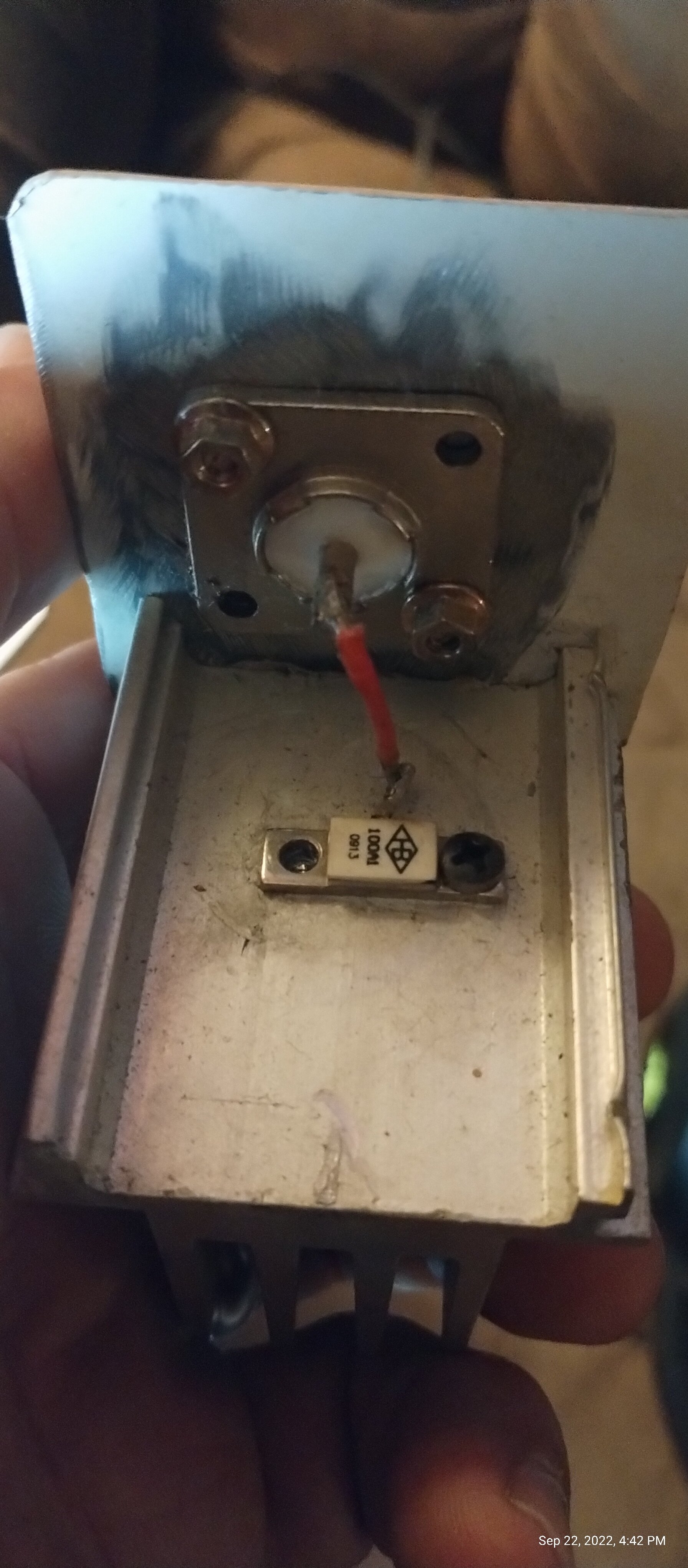

Just another way to provide some additional heat sink. I cut the tops and bottoms off two appropriately sized tin cans that would tightly sandwich all the resistors between them. By first laying all the resistors out like spokes on a wheel, a mark was made on the cans where each resistor lead was mounted. A small drill hole was made for each lead to fit through and later soldered. I like to think of it like a wheel, where the outside can is the tire and the smaller can is the hub. This structure can now be hung inside an even larger can with the hub connected to the center conductor and the tire connected to shield or ground. No problem handling 100 watts, at least with short bursts.
