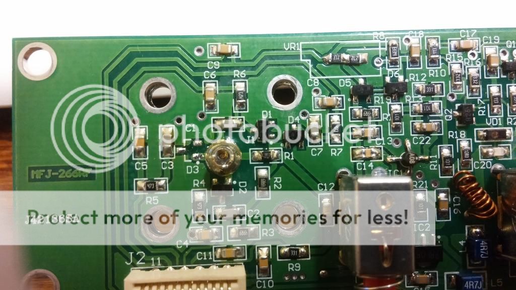

I have/had a working MFJ-266 I need the schematic or need to know what "D3" is on the RF board
it is a SOT-23 device with the markings "AH" mighty be a HV but I am 90% sure it is "AH"
the unit powers up and tunes I can here it on my radio but there is no SWR or impedance readings the device D3 was smoked I can only guess some one plugged it in to the radio and keyed off in to it "dam friends I am never lending out my testing gear" any way I think it is a 5.1v zener diode..

well it looks like MFJ cant help me. they cant even give me a schematic. I know 2 diodes D1 and D3 and R1 where cooked I replaced R1 I got the SWR reading back.
I used the info from http://802.11junk.com/jeffl/MFJ-269-repair/ to give me a guess at what there diodes where so I ordered 6 and was going to swop out D1, D2, D3, D4

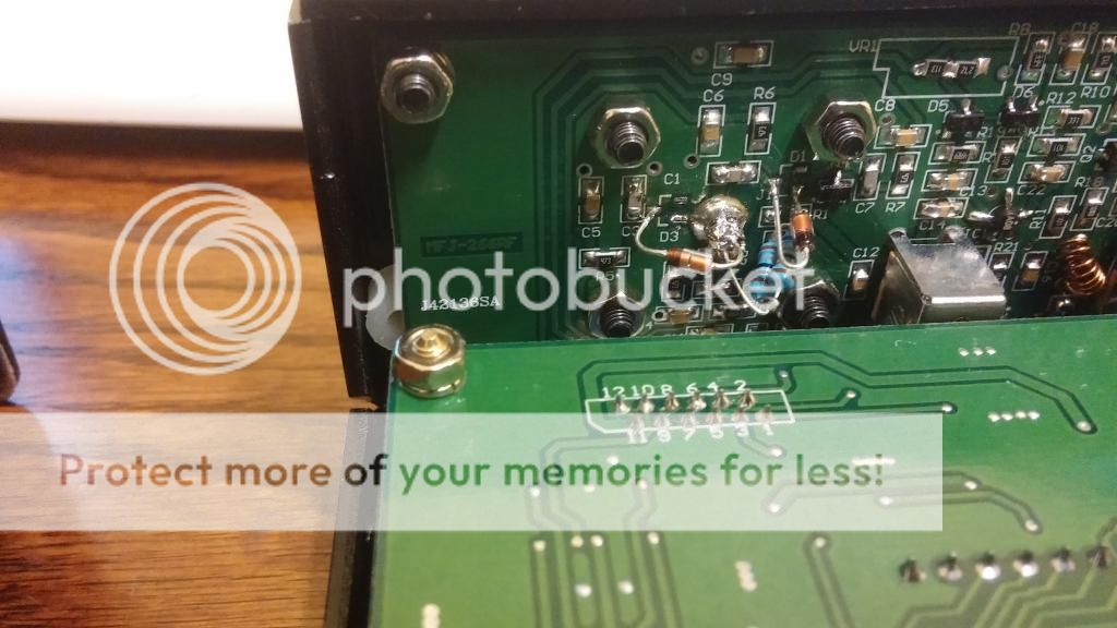

at first I just did the 2 that where shot... ok seemed to help I did D4 and lost the SWR readings put the old one back and got the SWR meter back... so there leaves me to guess the diodes are not right at all...

I have to do some more testing but I think I have it working 90% +
I tested some old schottky diode I snagged out of old radios..
