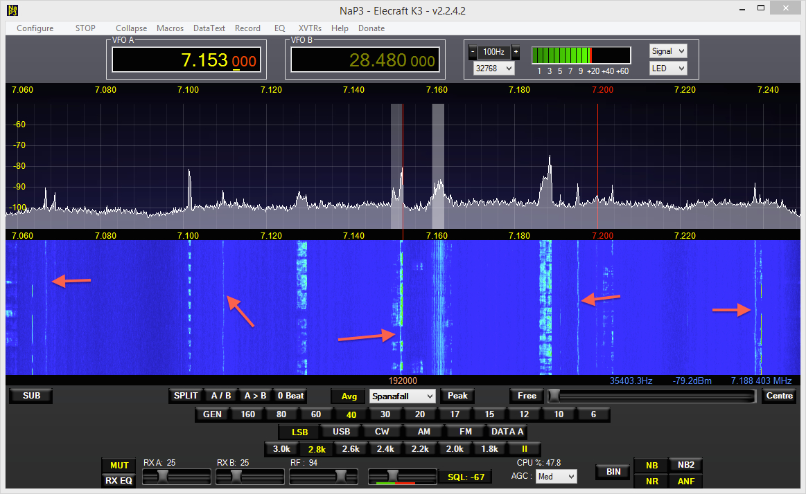

Unfortunately, this supply does exhibit quite a bit of hash. I've made sure the that the supply is properly grounded and even changed the AC power cord to a EMC Eupen ferried lined cable (which helped) but I still see and hear the hash.
Here is a screen shot of the hash visible on the panadapter screen, evidenced by the vertical lines that the red arrows are pointing to.

It's worth pointing out that this problem is fairly common with switching power supplies and is not unique to the MFJ products. Often I find that the hash is not strong enough to disrupt normal operations, but sometimes it is a real hassle to deal with. On my station, I'm going to move this power supply to mostly VHF/UHF and VHF amplifier duty, while returning the HF gear to a regulated linear power supply. I hope the information I've proved helps others make their own decisions.
