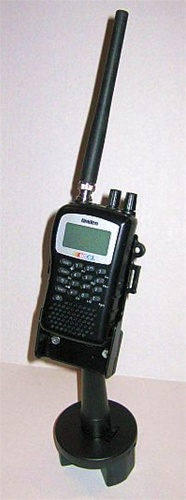

You could try this mount from mountguys.com. I got one for my VX-8DR and it works well. Lido makes a similar one also.

That cup holder mount would work perfect in my Mustang. I dont want a mobile unit in the stang and I am still debating the VX-8R. Not sure what to do for an external antenna, dont want to use a mag mount, maybe a trunk lip with a quarterwave since it will only be on 2m in the car for APRS. I probably put less miles on the car than ya put on that RV in a year :)
