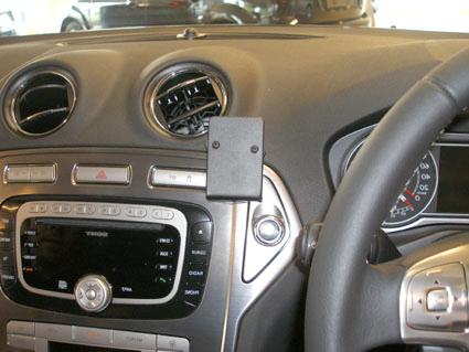

I'm not happy where the head unit is so I'm looking at using a Brodit Proclip mount currently holding my mobile phone holder to mount it up near the top of the dash. It'll screw straight onto that plastic bit. I've had a TS480 on that before so I know its sturdy enough.
