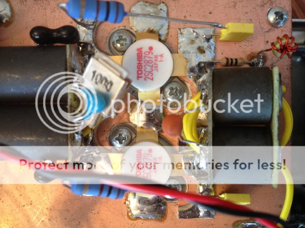

Specs: 2x 2SC2879 Transistors Capable of 400-525 watts of peak power as measured on a Bird 43P @ 15 Vdc with 40-125 modulation input. Dead key input should be from 1-15 watts. 2x 2” 4500 rpm fans ensure maximum cooling. Also has a ‘low-medium-high” power switch. Approximate HxWxD = 3”x4”x5”
I have never been impressed with big numbers from class C amp builders. Output devices are only capable of so much power output at a given feed voltage before they naturally distort regardless of who builds the amp. Distortion isn't a welcome thing. It can be a source of bleed-over to others. It robs power from the power supply. It is a cause of premature device failure due to the excessive heat/due to the square wave it is generating.
Two 2SC2879's fed @ 13.8v should provide no more 275 watts with relatively low distortion. Anything more than that is fluff. Read the spec sheets of these same devices sometime if you don't believe me.

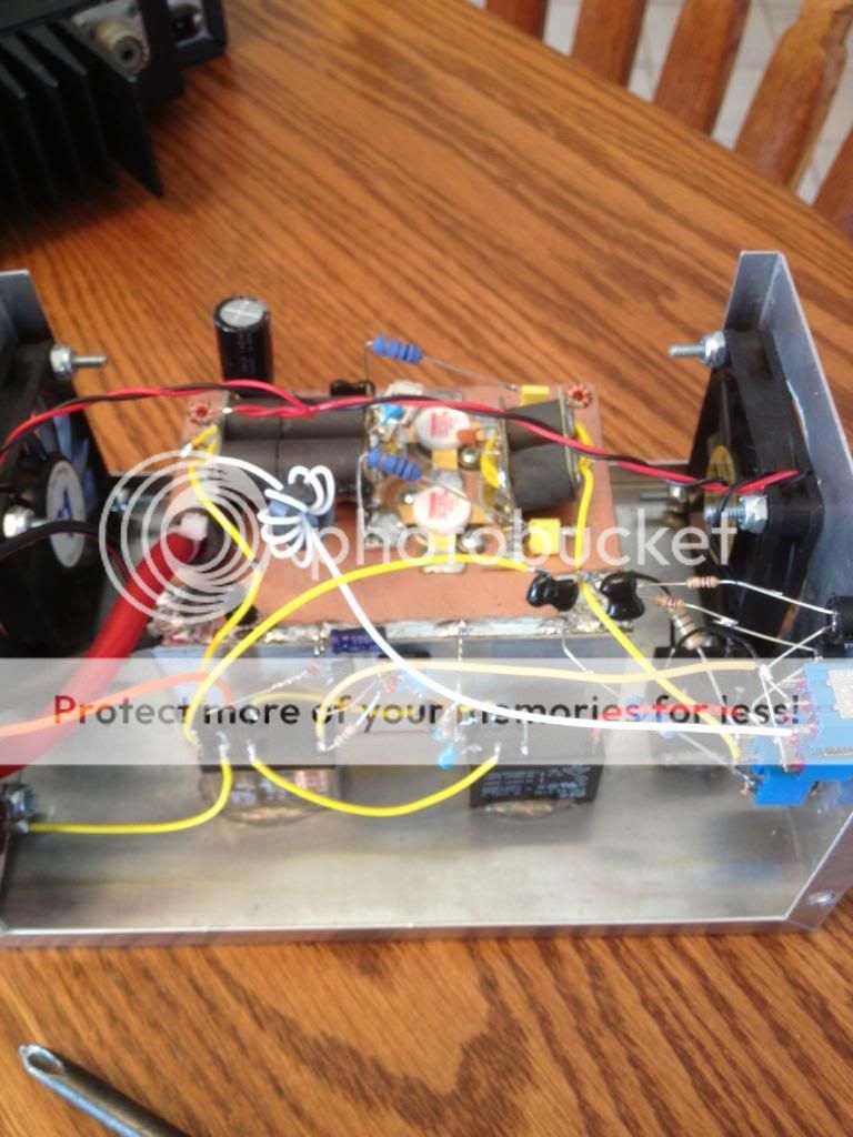

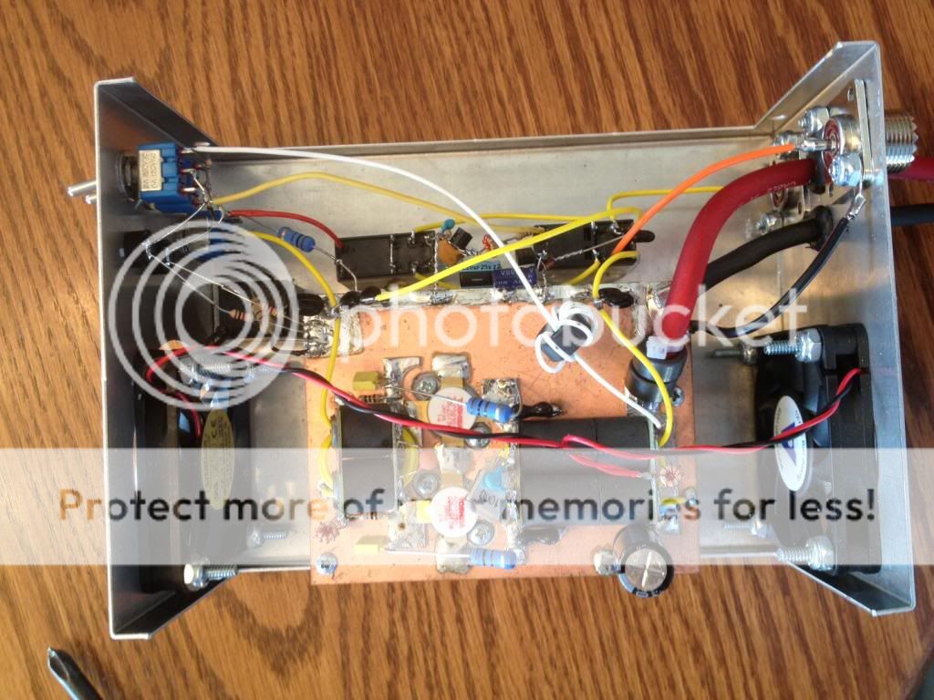

i hope one of those fans is blowing in and one out , other wise its not circulating air . the computer fans i've used blow air out of the side without the label ... and both fan labels are on the inside in the pic . one could be wired backwards to correct that though .
there is probably a vent hole under the heatsink with both fans pulling either in or out. if there is no vent hole the air will never circulate through the heatsink as there is too much space in the case.
