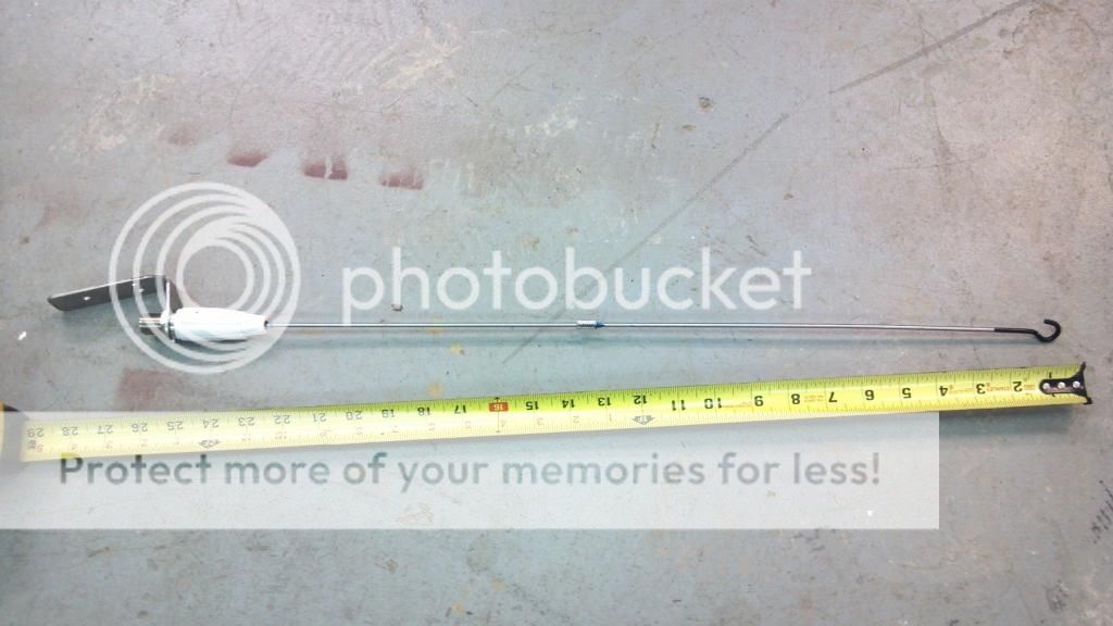

two piece, knurled insert in the middle, loop on tip, no markings or numbers, was unable to get below a 2.0 swr@ 170 with the MFJ.
Sturdy little thing ,just have no idea the application.
Try attaching two or three radials at the base and see what you get on 2 meters. Looks to be pretty long for 170, but ~146 might just be better. You will need a ground plane, though.
The hook would be for portable operation. I've made several like it with just an SO-239 and five pieces of solid copper wire each ~20 inches long.
Reactions: 1 person
thanks guys.
