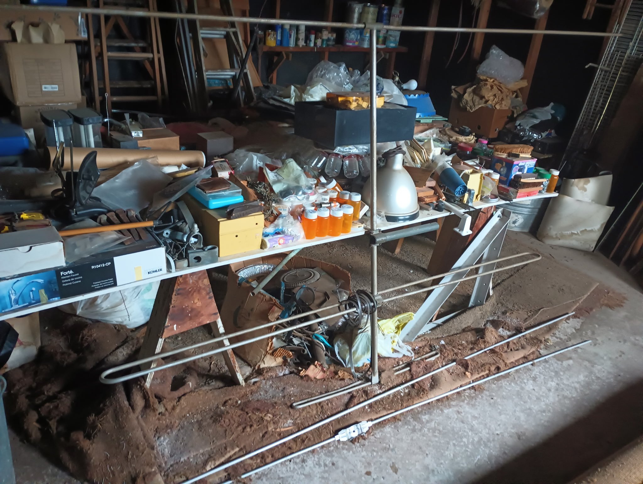

Hey guys,
I met a guy this morning that said he had an antenna he wanted to get rid of. I didn't see it in.person, but he sent me this pic. Anybody recognize what it is?
Biggest single hint is the driven element. It's a folded dipole. The 300-ohm twinlead wrapped around it is a proper impedance match for this type driven element. And the most-popular feedline for rooftop TV antennas in the analog era.
Yes, we figured that out. My contact kept saying the owner was a ham ip, so he thought it was for ham radio. Probably could have converted it into something I could use, but the elements were that old split type, and not a very heavy duty boom, either.
Oh well, you never know what you might find at these sk estate deals.
Thanks for all the input!
