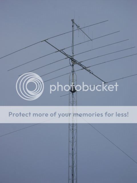

Hi guys, a friend of mine took this picture. He said it is a neighbor's antenna, and is about 35 feet off the ground. Can anyone tell me the manufacturer and model of the HF beam by looking at the picture?

The top antenna is a Cushcraft A270-10S dual bander for 2m/70cm with five elements on each band. The large yagi is a 15m monobander I believe. I scaled the size in relation to the known element lengths of the other yagi. It has a reflactor and a single director with the middle four elements all driven in what is called a log cell arrangement. You can just see the criss-cross feeders along the boom. Still digging for a manufacturer. It may be an old Hygain. My brain is foggy. Just got up and head is pounding. I hate night shifts.
Reactions: 2 people
Thanks Captain Kilowatt! I was puzzled by that arrangement on the boom that you mentioned, and wondered if it was possibly a multiband using different feed points. I tried looking at the usual suspects online, and didn't find one that looked like it. Really thought the dual bander was too small for anyone to identify, so thanks for that.
73,
RT307
I have a Cushcraft A270-10S so it jumped right out at me. LOL I also opened the image in an image editor program and blew it up to see the criss-cross feeders. Having a hard time locating a manufacturer and specific model number. Likely the antenna is old and obsolete as it is hard to get info on.
This is only a 4 element antenna but some of the hardware/cabling looks similar to the HF beam. The site doesn't give an overall picture so hard to tell.
Not sure if it's a Hy-Gain judging by what I can see of the coax to antenna connection.
Could be a homebrew? I recently purchased some antennas from SK estate and he had hombrew 6 element 6 meter quad on 3"OD tubing and the boom was 24 feet.

the hf looking beam is interesting with ass manny of the driven elements im wondering if its a log periodic of some type but the spacing on the front element dont make sence

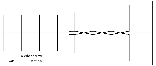

It is a monobander with a log cell driven arrangement like this.This image has a couple more director elements but it is the same thing. The multi element log cell arrangment allows for wide band operation over a single band but it is NOT multi band. As for the director spacing, it would depend on whether the antenna is optimized for F/B ratio or max gain. Looks like max gain to me with the wide spacing.
