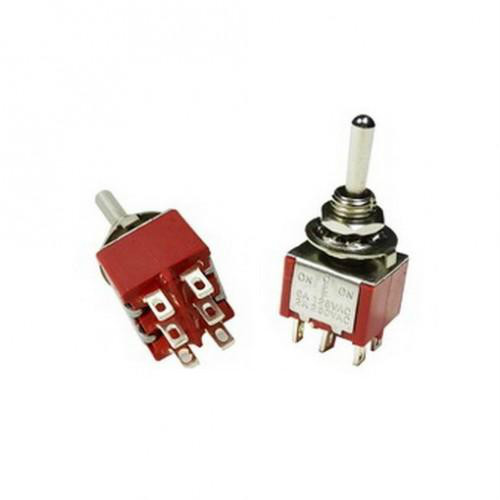

ok need help on which switch is needed i have the swing kit on my 2000k and i want to wire it thru a switch so when i need to run the radio back to stock just flip a switch, do i need a DPST or a DPDT Mini Toggle Switch ON-ON-ON or DPDT on OFF on ???

Determine how many "circuits" are affected by the mod first, then choose a switch by the number of POLES you will need to use to restore those circuits back to "stock"
For instance - a CB site says to do XX to Galaxy XX - you install a switch - but how many of those legs of the PLL will you have to "switch" to do this?
Each leg of the PLL - needs one POLE.

Now, count the number of circuits you change?
IN the above I see 2...
So you'll need a DPDT (Dual - POLE - Dual - Throw) to restore it back to OEM when you don't want to use it.
Why Dual Throw?
So you can apply a short using the POLE - so restore the original condition (you Throw it back to stock)
One direction of the switch allow you to turn on one circuit and bypass (short our or restore original condition) of another...

Don't use a "Center Off" DPDT - for if you do use it, you'll need to use something like a relay to restore the OEM and toggle to the other using the Switch - for it turns off the POLEs used to center - killing the circuit power flow.
Since there are so many types I just use pics to help - you decide what color or flavor or aspect of paddle to use...

Re-read his post.
You only need a ON-ON switch ....... DPDT .....
You don't want to have a middle position .....
Size doesn't matter, only the available room to install will determine the size .....
