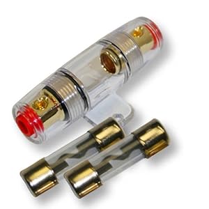

Ok , hey thanks for all the information so far , let me see if I've got it right , went and bought 8AWG wire ( Home Depot ) to run from battery terminals to bubble fuse holders ( Radio Shack ) , biggest fuses i could find were 60 amp ( Auto Zone ) , check coaxial cable if its rg58x replace it with rg8x , with amp off turn rf gain down to 2 watt dead key , turn amp on to no more than 200 w for a good clean signal , anything else , and let me say thanks for your help again , means a lot , thanks

Get an minimum 100 amp fuse and fuse both positive and negative leads ( negative leads carry voltage too) and go direct to the battery with both leads. This can prevent ground loops from appearing which can cause havoc on your radio and vehicles electronics. I experienced ground loops before with one of my mobile installs and this cured it.
Car stereo dealers sell the inline plastic bubble fuses for wire gauges up to 2AWG and I have seen them at Autozone too. Number 4 AWG is more than adequate for your mobile install since I doubt it will be more than 10 feet.
hey thanks for your help , i hope this is ok took amp to home depot matched wire size to 8AWG , this is what I'm using from the battery to bubble fuses , largest fuse i could find was 60 amp , not sure about coaxial cable yet , will know tomorrow , i have another question though , both the radio and amp have labels on the back saying antenna and transmit , can you give me an installation sequence , know what i mean
the 60 amp fuse will work for now but try to get a 100 amp in there when you can. The 8 gauge is fine as long as your not much over 10 ft.
