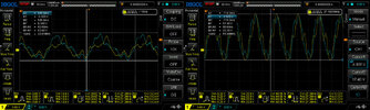

The two finals get about 12V p-p amplitude on the base but on the collectors I see only 20V to 22V p-p, whereas it should about 40V p-p according to the manual. Accordingly, in antenna on the dummy load I measure only 47V p-p, corresponding to 5.5W
Here are the signals on the bases of the finals (left) and on the collectors (right) (Tx AM unmodulated).
Here is another picture showing the collector voltage on one of the finals (blue) and on the antenna (yellow).
My suspicion is that only one of the finals is working, hence half the power.

(edit) incidentally - isn't it odd that the signals on the collectors of TR41 and TR42 are slightly different (picture in my first post)? they are wired together ...
