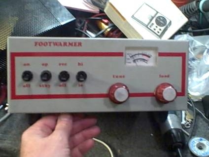

Would anybody have any information on this brand of amp, I would like to have a service manual or diagram I think someone has the wrong tubes installed in this amp it has 36KD6 tubes in it now and I think it needs 30KD6 tubes I have checked the web with no luck any inf is very appreciated.

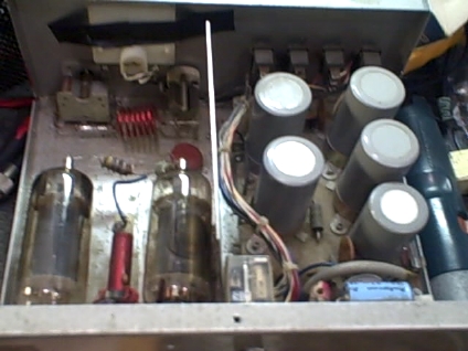

They are definitely 30KD6's. Sorry about not replying but this is the first I saw of it. I need some help from you. I have that same amp, and the coil that connects to the 2 plates. I need to know where the other end of that coil goes to. It came off. My email is:gjenginger@yahoo.com.

It should go to the pair of capacitors in the series (33pF rated for 500 volt) connected to the spot between the three resistors that are valued at, 10,000 ohms looks to be 2 watt each, the spot is located next to the end that is between resistor one and number two, that goes directly to the back trace where the resistors are soldered as well, according to mine.
