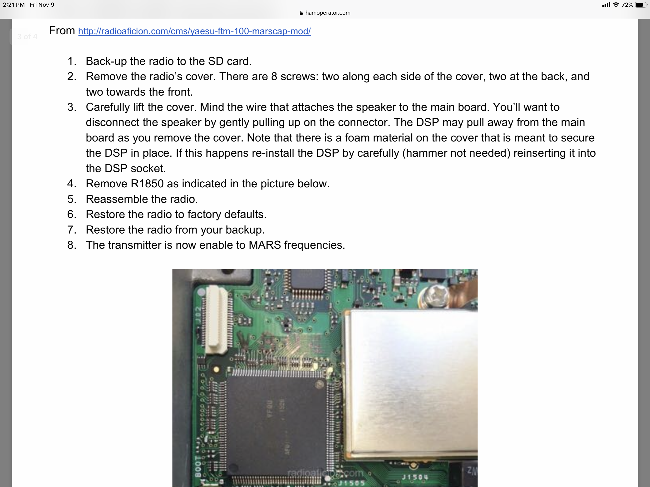

Need mod for Yaesu FTM-100DR
Here you go
The above photo is incorrect. That mod is for the European version. I believe this photo shows the correct resistor location for the USA model.
