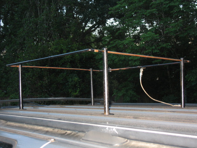

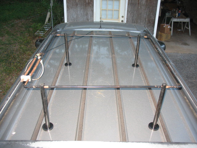

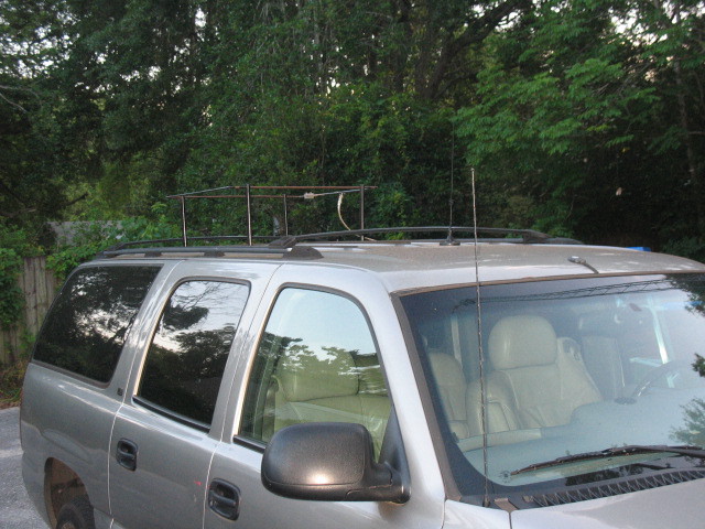

6m ssb mobile
This is my first post, hello to all.
I built this over a year ago and it worked well.
I made a few DX contacts into Wa. and into grand kayman Island was all the proof I needed.
The first 6m antenna I tried was the ATAS-100, it would load up but it was vert. needless to say how much better the loop worked with other horiz.
stations.
Going from never made a contact with the ATAS-100 to dx into Grand Kaymon Is. and ground wave comm 80 miles away.
The radio is a FT-100d with 100watts 50.125mhz VSWR 1.2:1
It works and I am happy!!:thumbup:
