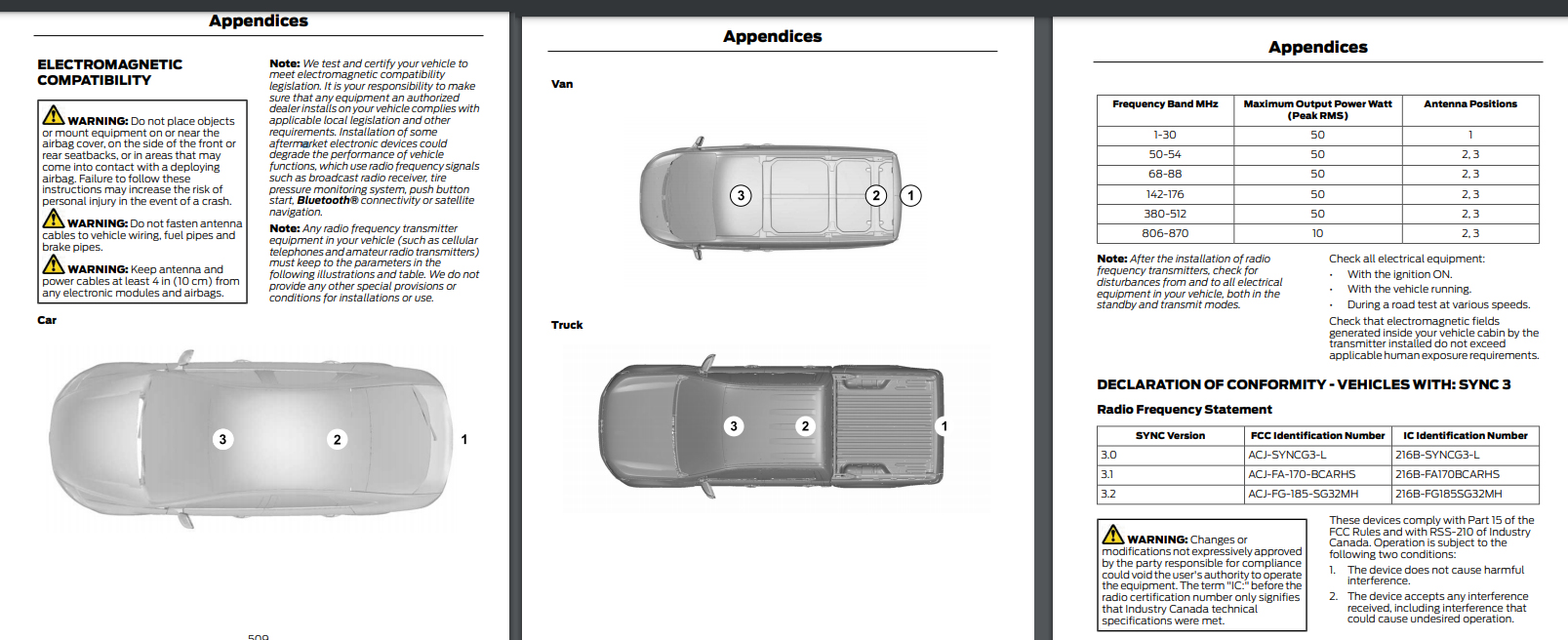

I was just looking at the recommendation in the manual for antenna mounting on some of the new vehicles and it's interesting. Only 50W max and they tell you to mount it at the back of the vehicle for 0-30MHz. I can't imagine 50W or even 200W from an antenna on the center roof causing issues. I thought I remember that the roof is supposed to be the best place for minimizing RF to passengers.

So what do you think of their recommendations?
I was going to install a McKinley with a kl7505 and Wilson 5000 mag center roof. Just wondering how careful I’d need to be with 200W or if I need to keep it at 100W or their 50W max.
Is it really that sensitive?
No HF 100W either in new cars I guess.

My December 2016 Hyundai I10 full gadgets does not care for 100 watt and roof mounted antenna from the FT100 on HF, nor 6 meter nor 50 watts on 2 or 20 watts on 70 Cm.
Most car manufacturrers just don't want to be hit by lawsuites so they stay on the safe side with claims what you can get in the car and power used.
Yes i have an OBD2 system, read it out myself here.
In case of doubt use ferrite near computer and the other computers for air bags etc
Bond everything well, i didn't run more as the 100 watts from the FT100 thoug, it is a bit difficult to drag the Heathkit SB-1000 in the car and run that long extention cord ;)
