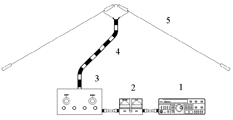

Nothing to it...ran one of these Field Day weekend...worked great...each side was 60 ft long #10 stranded copper wire from my scrap bin. We used maybe 70 ft of ladder line.
https://www.dxengineering.com/parts/dxe-wa-135
Everything you need to build one in the kit above...wire/300 ohm line/ insulators...and not priced badly for what is included...(I have 2 of these up on my lot) work great!!!
I will say a good manual tuner capable of 600 watts or more (many choices around both new and used) is a must. Most good tuners contain a 4:1 balun to feed these and your ready to work the world!:D
