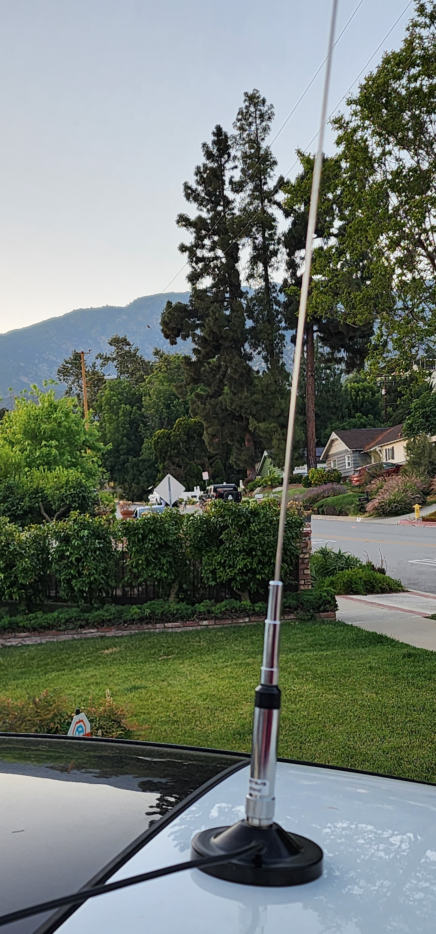

As you can see, this radio is very small, much like a Uniden Pro 520XL. It easily fits on just about any dash or overhead mount with the included mounting bracket. I tested this in my wife's car sitting on her dash with the optional, included mag mount antenna, which is rated at 200 watts:

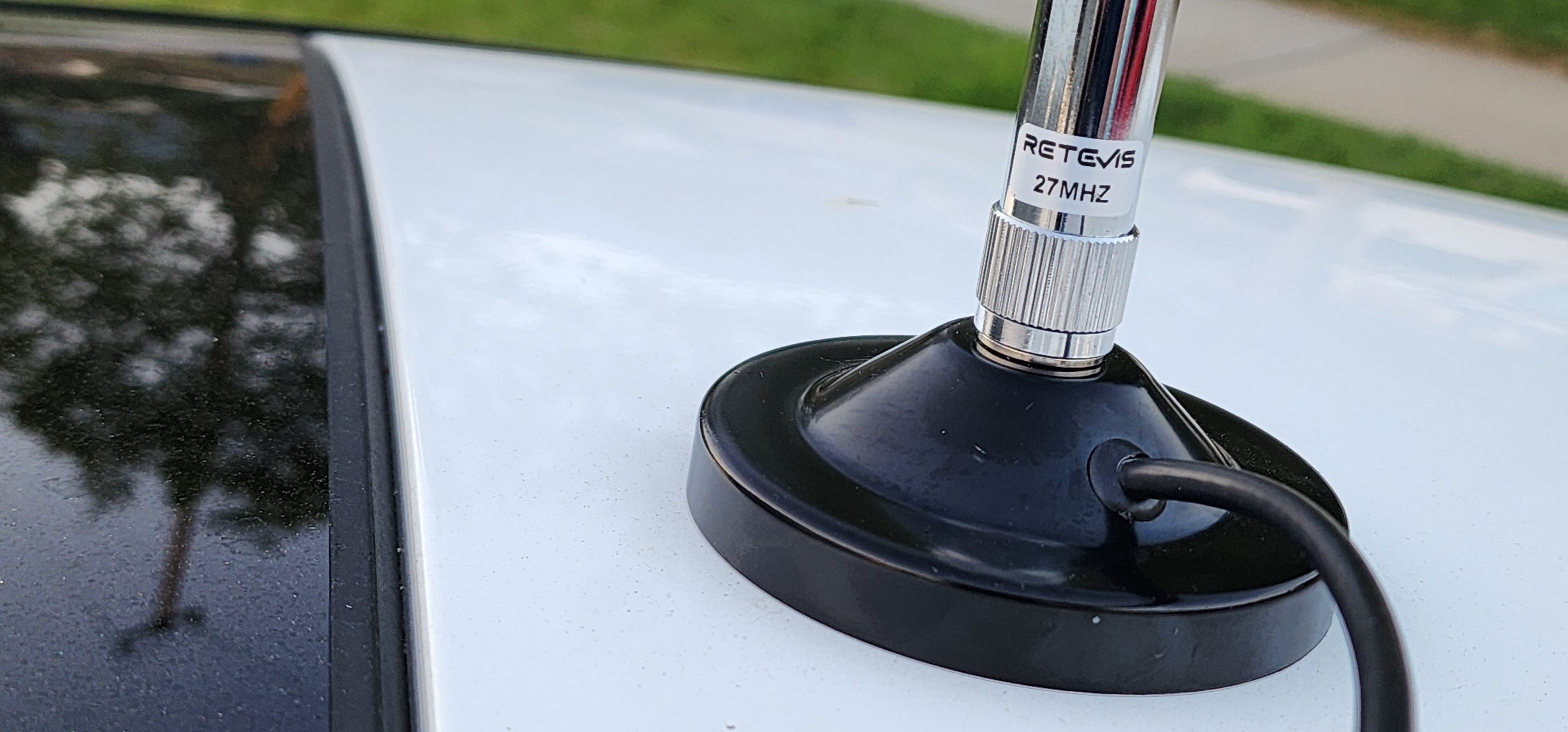

The optional mag mount is well designed with a standard SO-239 connector for the antenna and no-brand RG-58/U coax. The antenna is a center loaded, 45 inch antenna that reminds me a lot of the old Radio Shack CB antennas.

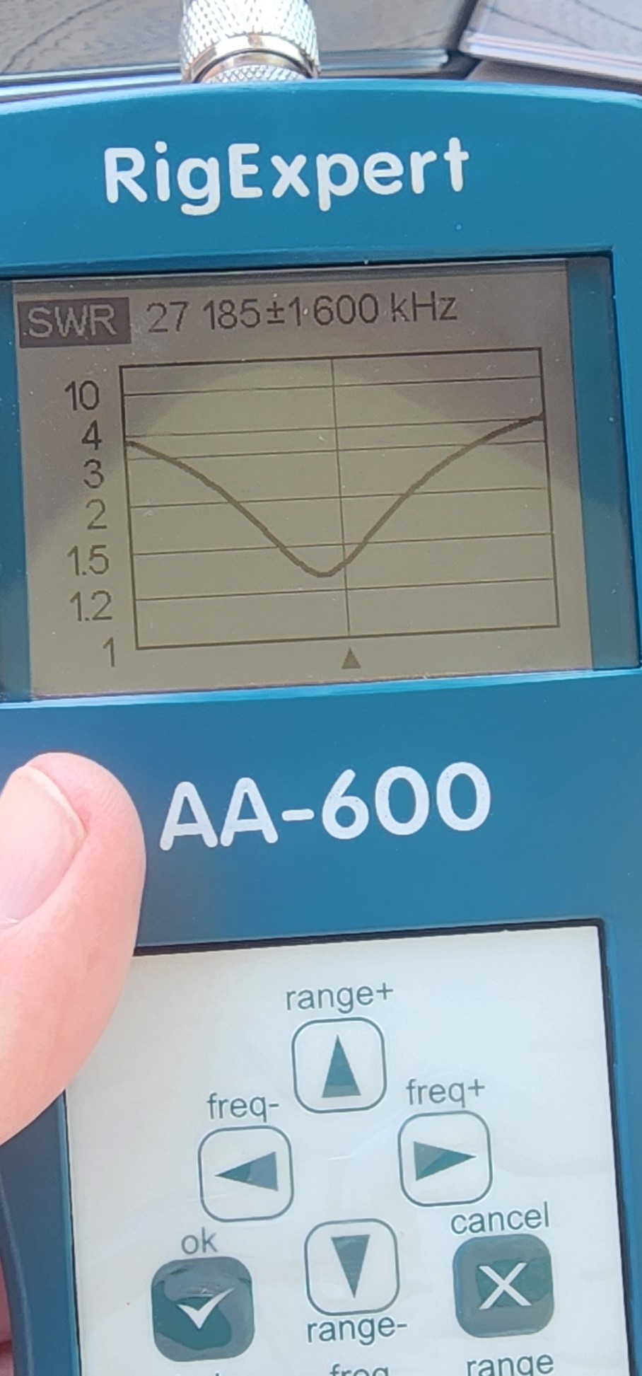

I used my Rigexpert AA-600 to sweep the antenna SWR bandwidth; it easily covers the entire CB band and then some with no adjustments. I just attached the whip, tightened the set screw and measured it.

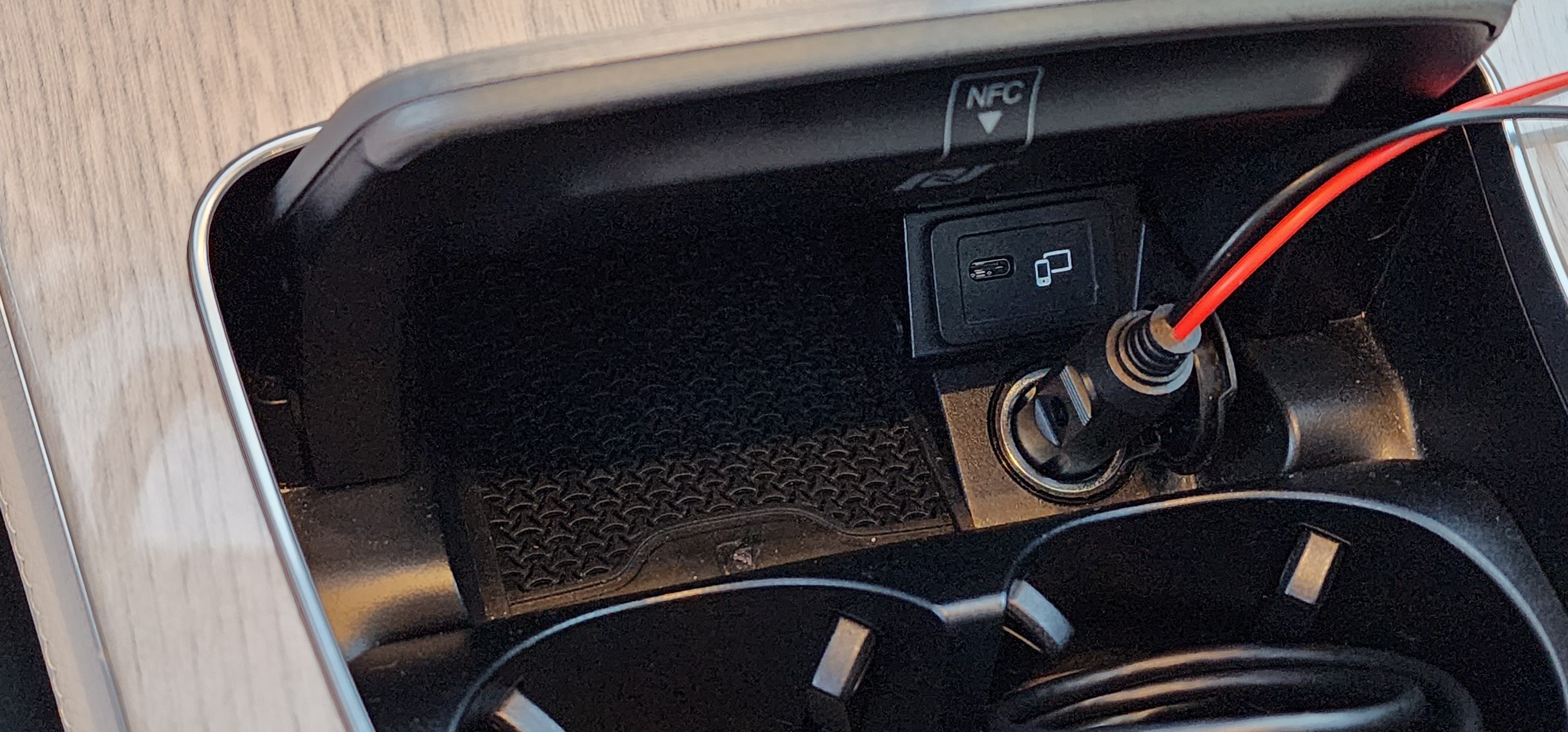

The MB2 CB comes wired with a cigarette / 12v accessory plug as standard. My vehicles still have this plug, but some users with newer vehicles without this plug may want to cut off the plug for other connections. If you're going to move this radio between vehicles or use on the base with a power supply, I suggest inserting a set of Anderson Power Poles to give you ultimate flexibility when hooking up for power. (Hint, if you're going to use Anderson Powerpole connectors, use authentic ones such as these sold on Amazon. The copy cat ones will cause nothing but grief.)

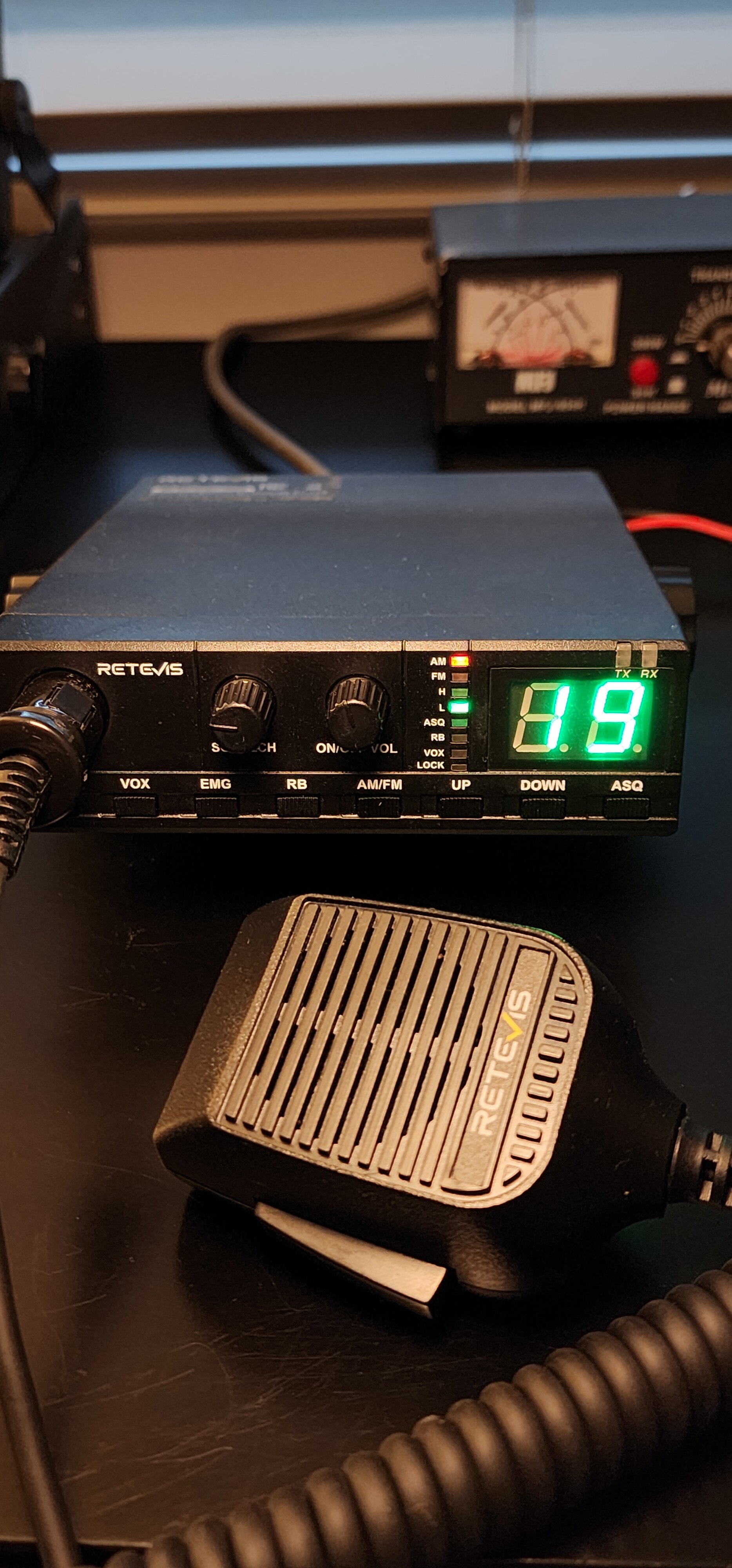

But it getts better. Retevis has supplied a power modification inside the radio from the factory. There is a white wire jumper on the main board toward the front of the radio, next to a 3 pin jumper block. If you clip this wire, new functionality and power output capabilities are unlocked. In this image, you can see that the "L" LED Is lit up., which means "Low". Under un-modified circumstances, neither the "Low" or "High" LEDs function. After modification, you can change power output by long-pressing on the AM/FM button.

On Low power setting, the radio power output is the same as out-of-the-box. But when the radio is in High power mode, I measured as much as 18 watts FM! The AM carrier on High is 8 watts, but it still only peaks somewhere between 12 and 16 watts. The high power output for FM is significant and will really help extend the range over the stock 4 watts. But on AM, the carrier to peak ratio isn't right and on-air reports described the audio as "muffled", as you would expect with a situation like this. For use on AM, I recommend leaving the radio on low power, but on FM, high power is your friend.

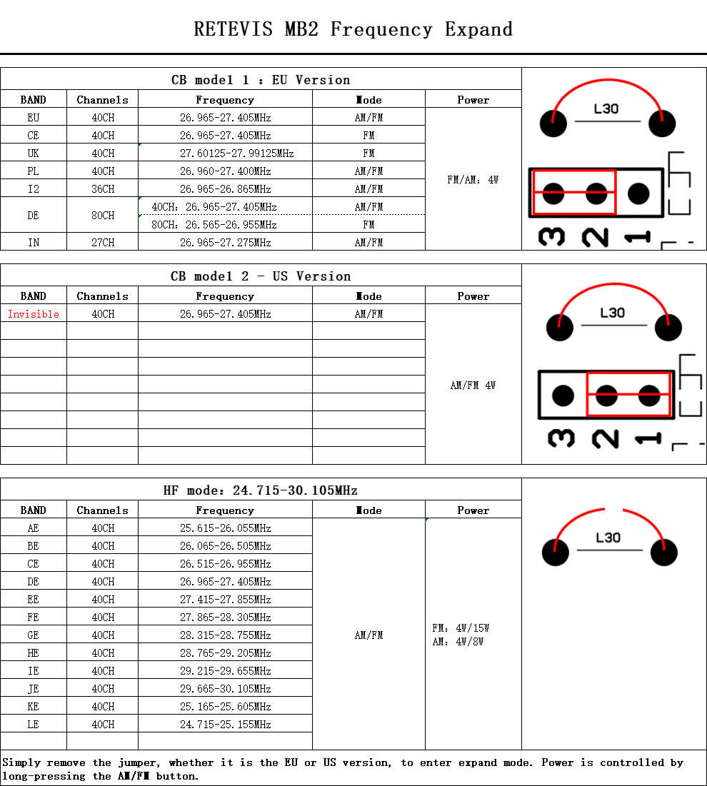

The MB2 CB is also intended for use in other regions, such as the EU. To change regions, you simply move the jumper on the 3 pin jumper block to suit your needs. The explanation, as well as a footnote about the power mod follows:

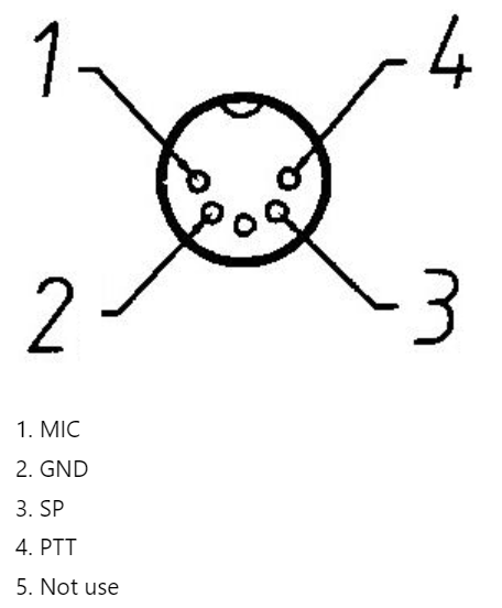

Excellent review! The mic pinout diagram does not match the one that I just bought from Amazon (Dec 2024) Assuming the diagram is looking into radio, I have: (using their pin numbers from diagram)
1. Gnd when in TX
2. Gnd when in RX
3. Mic audio and 3-4VDC
4. Ground
5. No Connection
It is an electret condenser mic. I have attached internal pictures of the mic. I verified this carefully and measured the voltage. 4.1VDC with no mic, 3.2V with mic connected.
