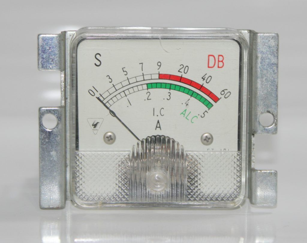

thanks got alc adjusted having a brain fart can remember on the meter scale where 60ma fo ic bias adjustment falls in
