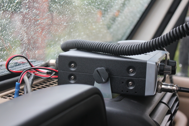

Today I installed the radio in my Jeep. For anyone familiar with Jeeps, you can appreciate the serious lack of room for radios. The Uniden 680 fits nicely in my chosen location which is right on top of the dash in the little tray. You can see in this picture where I placed it:
I like how the depth of the radio is much shorter than many of the other CBs on the market. In this side view of the installation, you can see how much room it takes on the dash:
Most other radios that I've installed in that location have the rear almost butting up against the windshield.

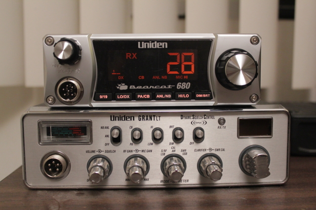

This completely new CB was provided by Uniden, so here are some pictures of the radio while we're working on a full review. First, you can tell how small the width of the radio by comparing it to the full sized Uniden Grant LT:
Notice that the height of the radio is similar to the LT, but the width is much smaller. The large height allows the display to be large and very visible.

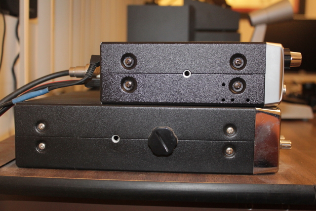

Here is a side view of the 680 on top of the Grant LT. Notice how much shorter the new radio is, which is quite advantageous when trying to fit it into small vehicles:

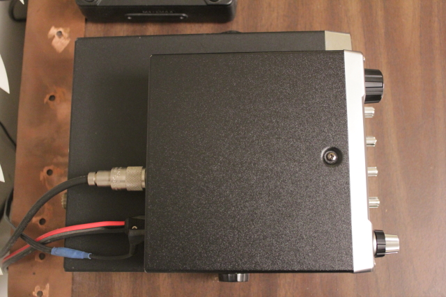

Here's a view from top comparing the over all width and depth differences between the 680 and the full size Grant LT:

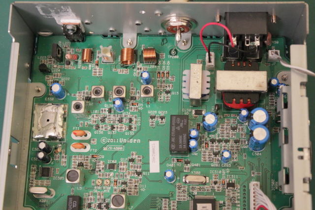

Next, some inside shots. Here is one of the final PA transistor and output filter. The radio uses the familiar 2078 transistor:
Another, broader picture of the main board:

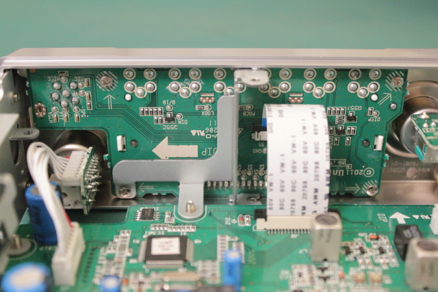

Here is the back side of the front face circuit board:

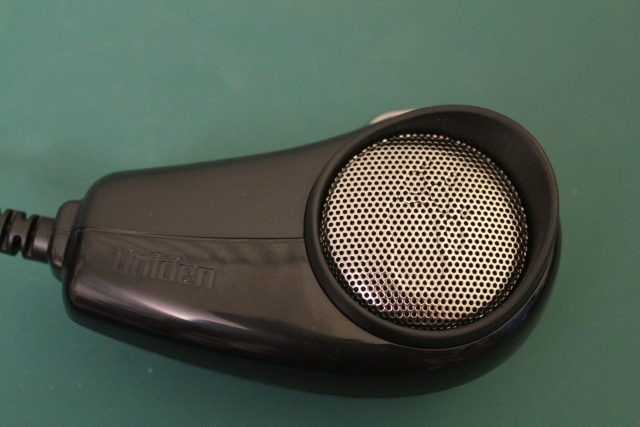

This is the stock mic. It looks funny, but is very ergonomic:
From the side, you can see that the mic has a lip guard which lets you feel how far away to hold the mic:
